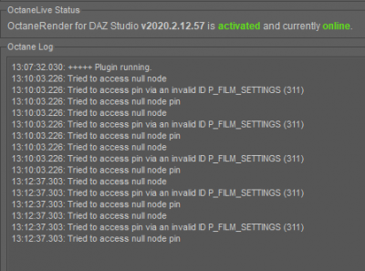

if i export all render passes using PNG16 the current set Gamma is ignored. He exports them with Gamma 1 instead of 2.2. In the viewport it is displayed right, but exported the single layers are dark. If i save only one layer, it is exported correctly too. Is this a bug or am i missing a setting?

Kanne wrote:Hi,
Hi Kanne,
Thank you for the post.
We are unable to replicate this.
Could you please confirm if you are running this build?
Cheers
Kind Regards
bk3d

BK wrote:
Kanne wrote:Hi,
Hi Kanne,
Cheers
I can confirm, see screenshot attached. Is it possible those old "pins" are causing these issues? Can i get rid of them without recreating the whole scene? It's quite an old scene i keep updating. I created new render-settings and a new camera, but still using the the export all passes function, no mather how many and which, does not get exported as linear with gamma 2.2.

Hi Kanne,
thank you!! we are able to replicate this now.
We will get this fixed in the next release.
In the meantime, please export the render passes from the Animation tab.
cheers
Kind Regards
bk3d
