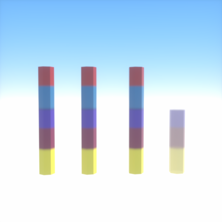

Ah, that's why I couldn't make it work either. The files are most likely coming from Quill's Alembic export, there is no option to change the data type in the export dialog.abstrax wrote: I had a look a the scene and the file "tube_opacity.abc" has a vertex attribute array "opacity" of type float64 (double). As we currently don't support float64 attributes, it doesn't get loaded.
From where is this file exported and do you've got any control with which data type float vertex attributes are exported?

Yes exporting out of Quill.
Thanks for clarification. Makes sense! What float type is supported, float32?

Yes only 32bit floats are supported right now. Will try to extend that to float64 (converting down to float32), but haven't had time yet.Goro wrote:Yes exporting out of Quill.

Fortunately it was a fairly simple change and will be in the next 2020.2 release.Goro wrote:Yes exporting out of Quill.

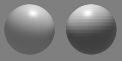

Haze, this problem has been brought up before (see viewtopic.php?f=9&t=74760 )haze wrote:Is it possible we could have the scene please? Thanks in advance.Zay wrote:Was trying out Random Walk on a specular material. Seems like there are some smoothing problems when you got up close.
I'm not sure if Zay sent you his scene, but I have also attached a simple scene demonstrating the problem.
The higher the medium density gets, the more faceted the surface appears. You can subdivide the mesh more to try and work around the problem, but this is obviously not a great solution (scenes get very geo heavy).
1. Load the orbx and select the render target to start rendering
NOTE: Both spheres use the same geometry. The left one has a glossy material, while the right uses a specular + random walk
2. Select mat2 > medium > and adjust density slowly from 10 to 500.
RESULT: At 10, you dont see any faceting. Once you start getting to around 100, faceting appears.

Yup, I sent him a PM. Not just in random walk I see this. Seems like it also have to do with indirect light and how light is falling on the object.funk wrote:I'm not sure if Zay sent you his scene

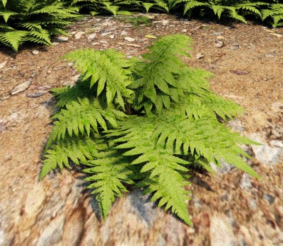

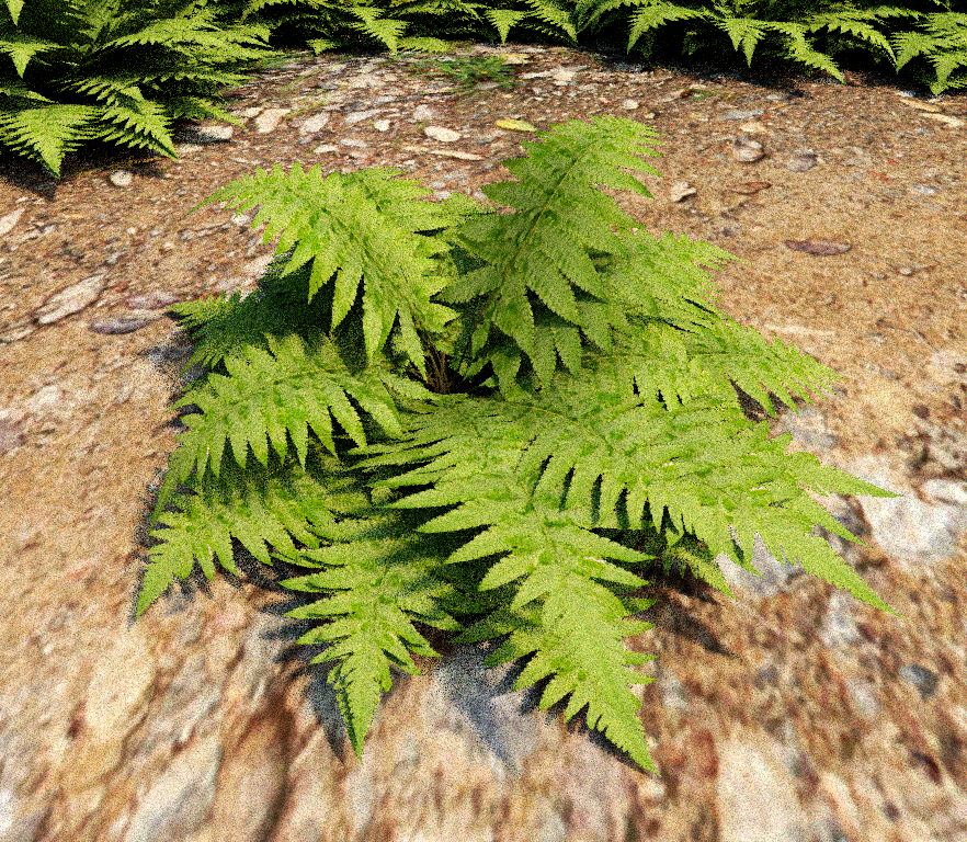

When scattering an object, is there a way to avoid objects being scattered in the same position?
Here are about 4 objects (ferns) scattered in the same place.

Which distribution model did you use? Surface area and Relative density should produce better scattered objects. If you use one of these and you still have 4 on the same place, maybe there is a bug somewhere, in which case it would be good to have the scene so we can investigate.Zay wrote:When scattering an object, is there a way to avoid objects being scattered in the same position?

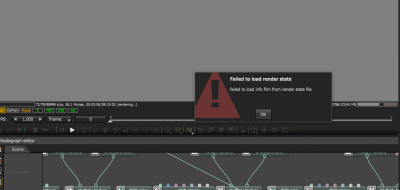

Thanks for the report. This problem will be fixed in the next release.Draydin_r wrote:Ran into an Error with loading render states on several scenes now.
