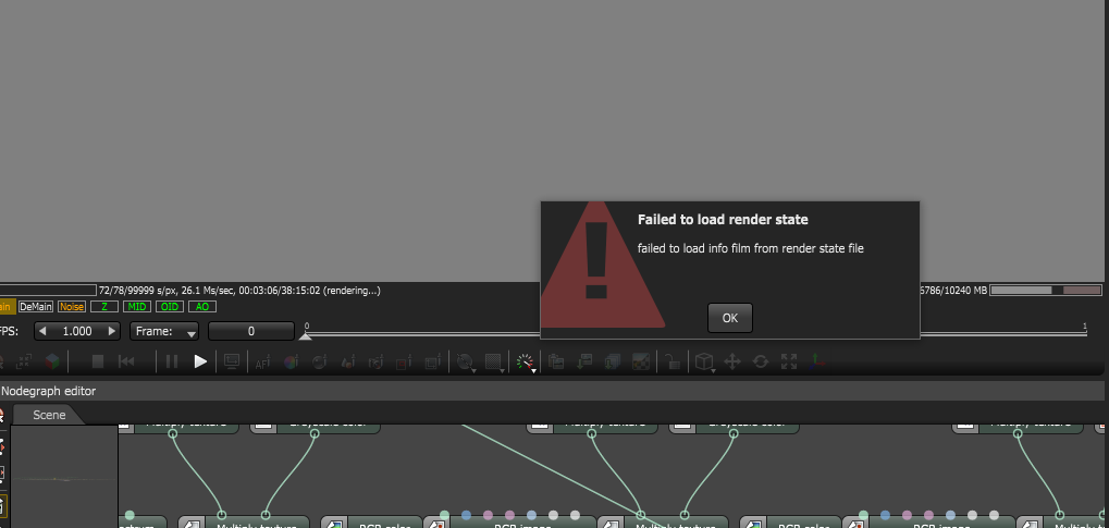

Ran into an Error with loading render states on several scenes now.
Intel Core i7 CPU 6850K @ 3.60GHz 128.0 GB Ram / Win 10 64 bit / 1x GeForce RTX 3080

Draydin_r wrote:Ran into an Error with loading render states on several scenes now.
Thanks for the report. This problem will be fixed in the next release.
