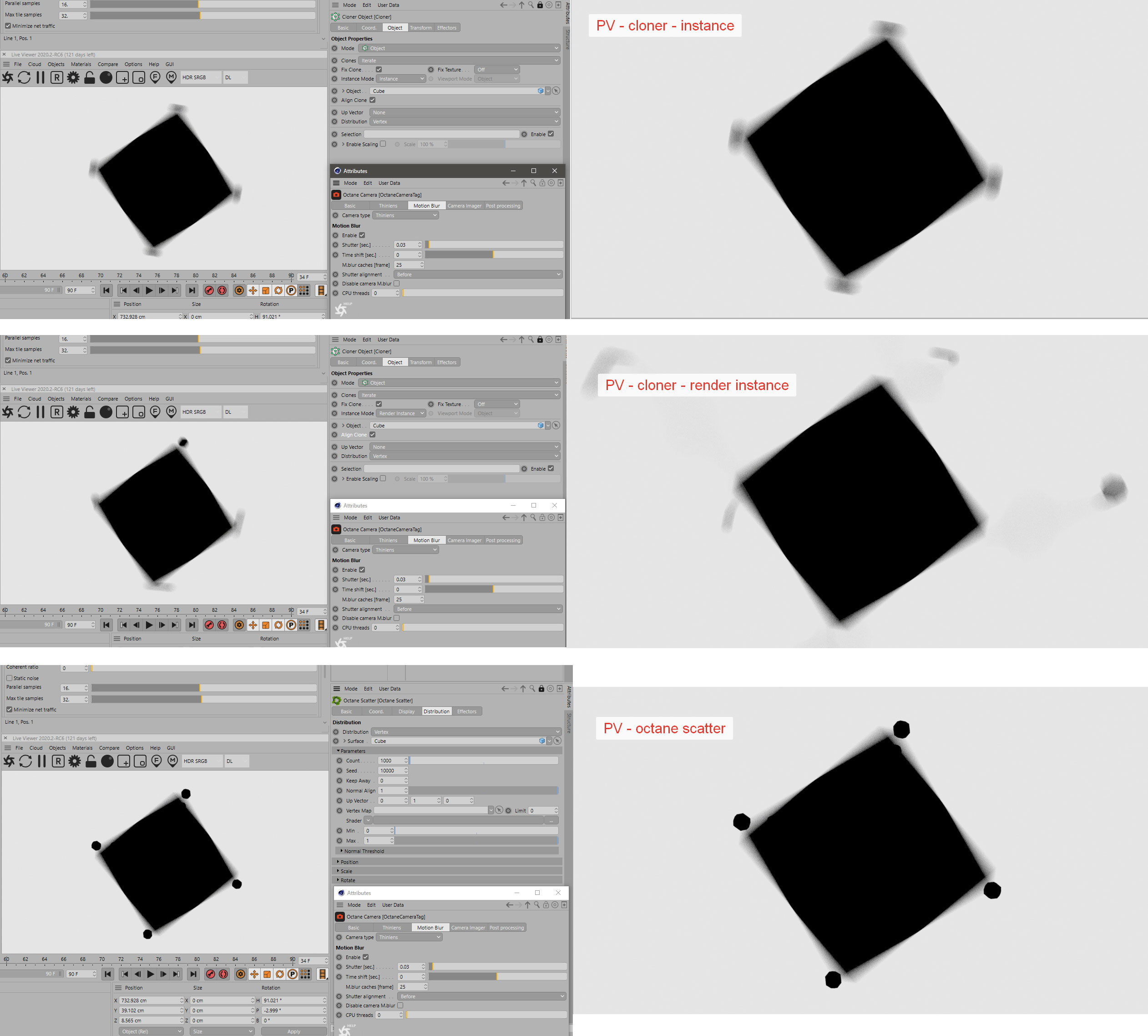

Hello!
Sorry for may be dumb questions...
What a chance to get Motion Blur of OctaneScatter objects simple way? (no MoBlur with different settings)
Aaaand which way get a right MoBlur with MoCloner and RenderInstance? (instances chaotically change their position in PV and look weird in a LV)
Tested on this and older 2020.1.5 plugin versions.
Please see attached image. Thank you
