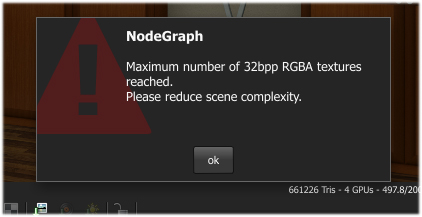

I don't know, bug or not bug, but I have 3GB cards, scene takes 497MB only, and I got this. I need ALL these textures in that scene (each one is important for entire scene), I have GPU memory for it, but can't have it in scene...:(

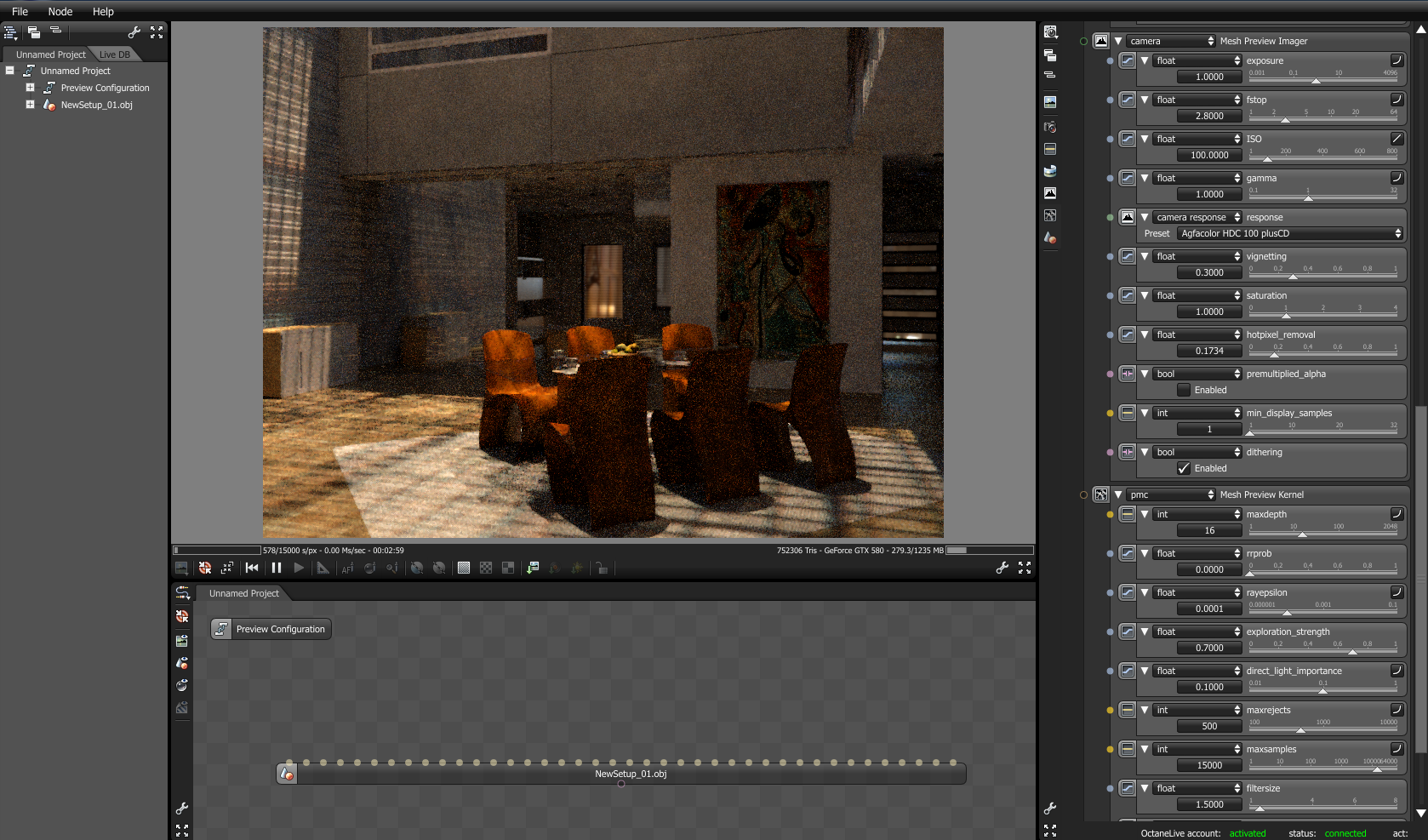

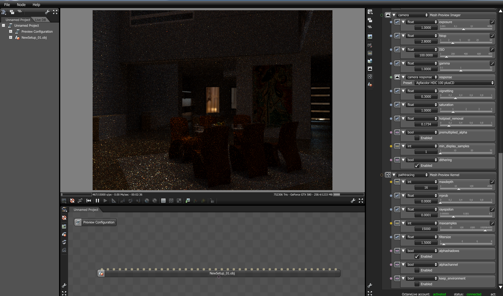

Greetings, i have a bug to report. Portal doesn't work with the pathtracing, here's the images:
Pathtracing
PMC
It's exactly the same scene, just different rendering engine and these are the results.... BTW i didn't have any problems ruining this version, no extra firewall setup

Saramary wrote:I don't know, bug or not bug, but I have 3GB cards, scene takes 497MB only, and I got this. I need ALL these textures in that scene (each one is important for entire scene), I have GPU memory for it, but can't have it in scene...:(
Not a bug but a limitation. And to quote Radiance for a workaround:
"Some tips:
* Use grayscale where needed, eg use a floatimage to load any image type regardless of colour on channels that don't require it, eg bump, spec, alpha etc...
* use alpha in a RGBA texture instead of another extra separate floatnode, eg you can load a RGBA png into one RGBA alphaimage node (for A) and one imagenode (for RGB), they will use the same texture internally of the 64 RGBA textures possible, as long as it's from the same image file (eg png).
* consolidate multiple textures into one larger image, recompute your UVs (some 3d packages offer tools to do this)
* use procedurals where appropriate (you can have an infinite amount), good for repetitive bump maps etc..."
... to be precise, a limitation of CUDA, not Octane ;)
AFAIK there are a max. number of 64 image and 32 float textures, as well as 4/4 HDRI rgba and greyscale textures possible.

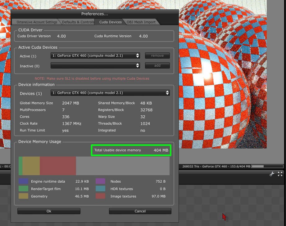

My GTX 460 has suddenly only 400 MB of memory :shock:
I cannot render older projects that require more memory:
Code: Select all
CUDA device 0: Not enough memory to allocate buffer of 15399600 bytes for texture 11
CUDA device 0: KERNEL FAILED!!!
CUDA device 0: Not enough memory to allocate buffer of 15399600 bytes for texture 10
ERROR: Program executed illegal instruction.. terminating
