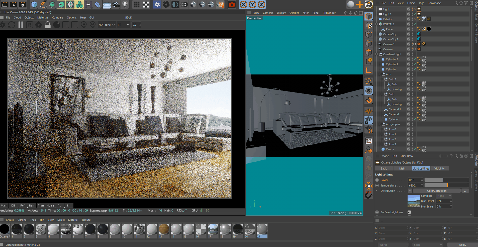

Hi, Aoktar
I have been experiencing some weird behavior with several scenes with the live view window: during some light plane editing the live view goes really weird. I attach an example of the bug moment.
Restablinshing the correct view is easy by reloading the liveview.
Thanks for the hard work.
Reloading the liveview fixes the bug until the following light editing.

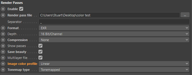

The EXR color space seems to be off on this newest build. I've attached what I have always used as my render settings for probably the past two years. However, now when I go to edit the image it's super dark. I know how to set the AE project settings to linear workflow to make it look correct. I know linear is the way to go... but I like my current tonemapped workflow haha :D It seems that when rendering PNGs instead of an EXR with the image color profile set to Linear and the Tonemap type set to tonemapped, as I have set in the screenshot, it works as it should without any issue. I guess what I'm saying is it does not work the way it use to for all of the past versions for me. Any ideas on this?
p.s. I also render from the C4D picture viewer, not the Octane live viewer.
Thanks!
Render color profile settings.

Kalua wrote:Hi, Aoktar
Do you have displacement in materials? There's a bug with that
Kalua
Posts: 572
Location: Caribbean Sea
Yes. In one of them: the concrete wall. I will play it without displacement to see if it responds accordingly.
Thanks for letting me know.
EDIT: It is correct: displacement is causing troubles in this release.
