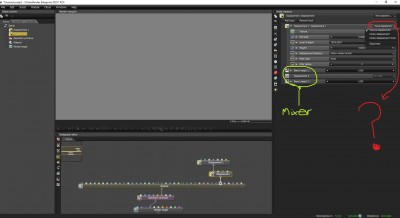

I don't know if this has anything to do with the recent posts as I'm not an expert at all on this.
But the Texture displacement does not work when put in the Vertex mixer.
Not just that, but The Vertex mixer's stability when added to a material is very skiddish and crashes standalone.
But admittedly this is old news pretty much I guess.

There's a reason why the node is called Vertex Displacement mixer. You can only mix Vertex Displacement nodes, not Texture Displacement.
I think we are both confused then, do you know why the Texture Displacement option is then in the Vertex Displacement Mixer?linograndiotoy wrote:There's a reason why the node is called Vertex Displacement mixer. You can only mix Vertex Displacement nodes, not Texture Displacement.
Otoy - if what Lino is saying is true, that the Texture 'option' is really an inactive legacy component, he has thought of great idea -
could you guys then make a Texture Displacement mixer!???!!!!!
This would rock, I have tried adding Composites together but only one displacement operates in that scenario. Otherwise I have to string together Multiply, Add, and stuff like that in a single Texture.
It gets messy and wonky because you only have one Mid and Height.
And like I said using 2 Vertexes is skiddishly unstable and crashes scenes.
THX!
