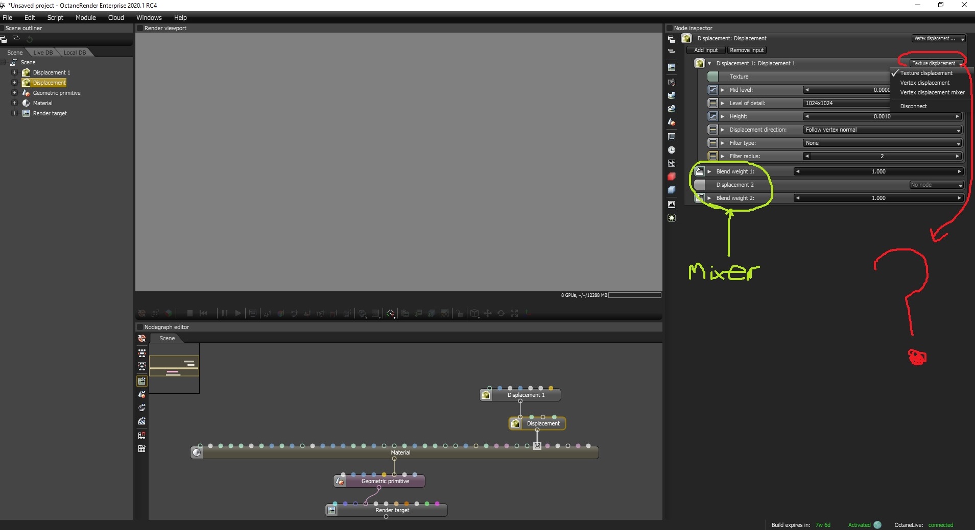

Notiusweb
Posts: 1285
linograndiotoy wrote:There's a reason why the node is called Vertex Displacement mixer. You can only mix Vertex Displacement nodes, not Texture Displacement.
I think we are both confused then, do you know why the Texture Displacement option is then in the Vertex Displacement Mixer?
Otoy - if what Lino is saying is true, that the Texture 'option' is really an inactive legacy component, he has thought of great idea -
could you guys then make a Texture Displacement mixer!???!!!!!
This would rock, I have tried adding Composites together but only one displacement operates in that scenario. Otherwise I have to string together Multiply, Add, and stuff like that in a single Texture.
It gets messy and wonky because you only have one Mid and Height.
And like I said using 2 Vertexes is skiddishly unstable and crashes scenes.
