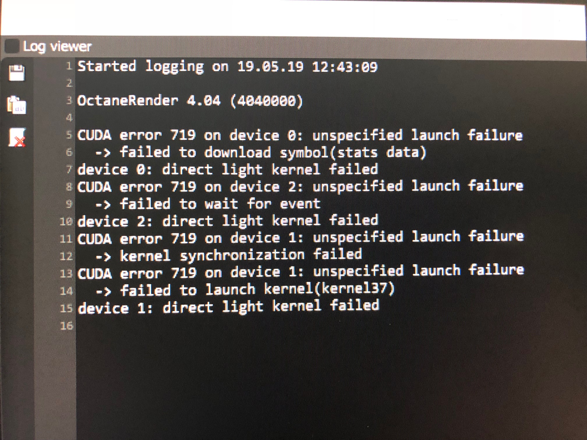

with this version 3ds max would just close itself during rendering. No errors, nothing.
Sometimes this error failed to download symbol
What does it mean?
and now these errors again
CUDA error 700 on device 2: an illegal memory access was encountered
-> failed to wait for event
device 2: direct light kernel failed
CUDA error 700 on device 1: an illegal memory access was encountered
device 1: direct light kernel failed
UPDATE:
Can a bad/faulty connection or network card on the master cause these errors? I noticed one time when viewport was opened network slave count was going from 20/20 to 10/10 and then back 20/20 (There are two slaves each holds 10 GPUs).
Both slaves had an error message about a stopped heartbeat. Octane on these slaves was restarted and it kind of fixed the problem but then if octane restart fixed it for now it can be a software problem.

Hi coilbook,
could you mail this issue to Octane help desk please?

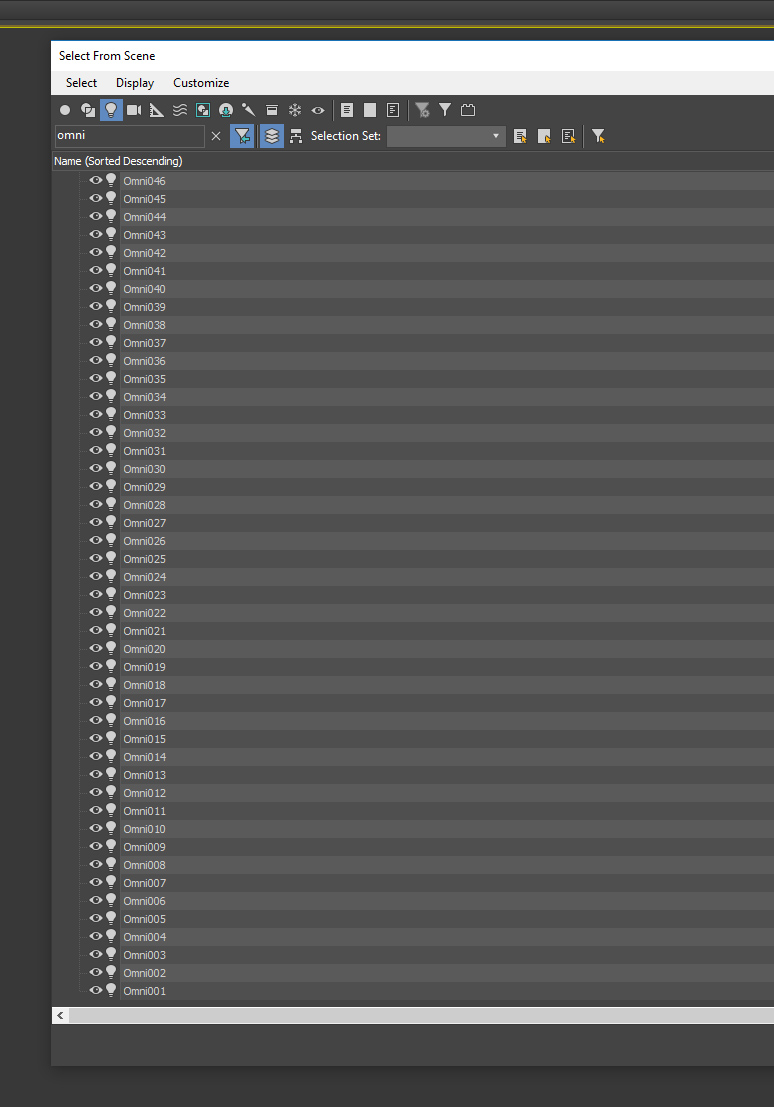

HI Paride,
not sure if you can help me with this. When octane viewport is opened and I have phoenix fire in the scene if I drag a time slider while octane viewport is opened 3ds max gets very slow because phoenix or octane creates 500 omni lights. I am not even sure if it is octane/phoenix bug or or just phoenix bug. Thanks

Hi coilbook,
I never had seen that issue before, could you share a file to me please?
