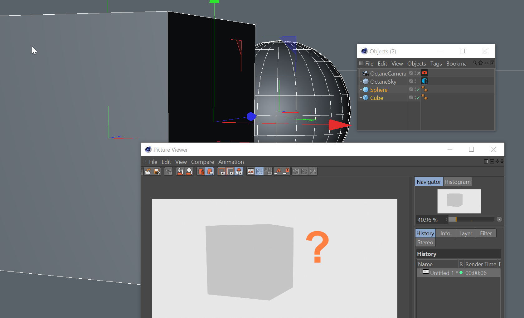

Two Bugs Here.....
01. Can't render Para Sphere (Parametric Not a mesh) 2018.1.2 & 4.04
make sphere. add env. set octane
-Very First Render to Picture Viewer : Can't Render
-Open Live Viewer & Preview. After Render to Picture Viewer : Ok....

It's not a Bug. You should know as an old user that you can't render spheres if you select "Render Perfect". Plugin deactivates this option when you start LV the spheres in scene.eyeonestudio wrote:Two Bugs Here.....
-Open Live Viewer & Preview. After Render to Picture Viewer : Ok.... - Ok

You right. That is not a bug. I had forgotten it. No one renders without an LV preview. It's just inconvenient.....aoktar wrote: It's not a Bug. You should know as an old user that you can't render spheres if you select "Render Perfect". Plugin deactivates this option when you start LV the spheres in scene.

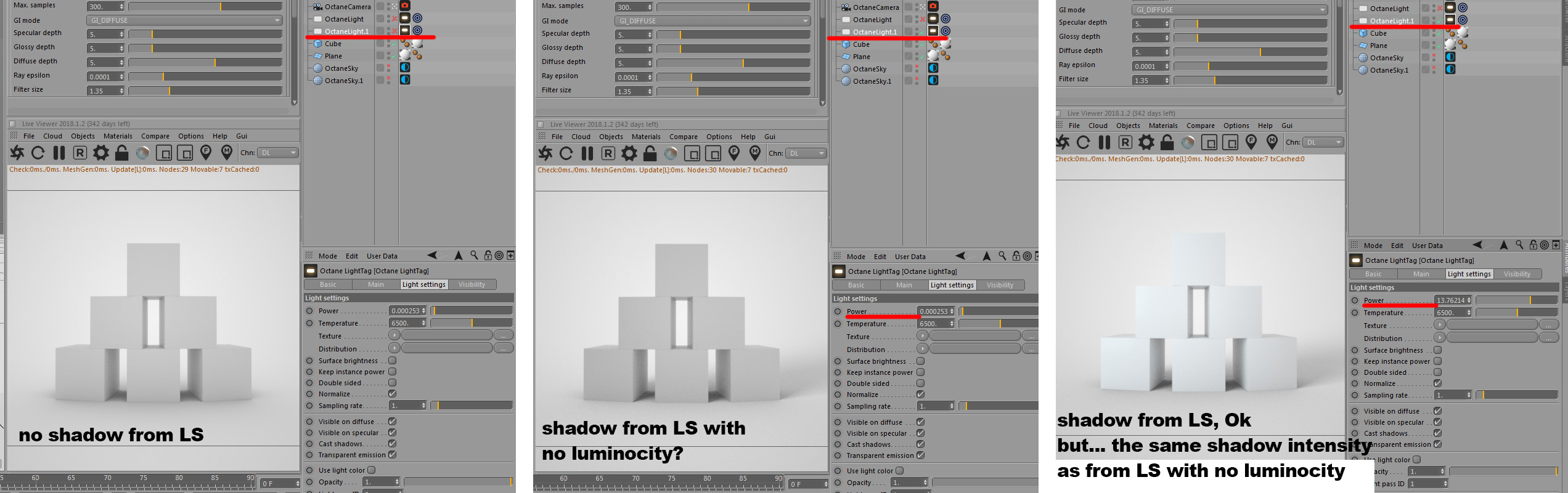

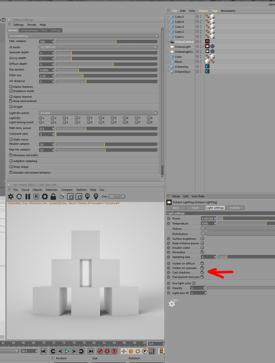

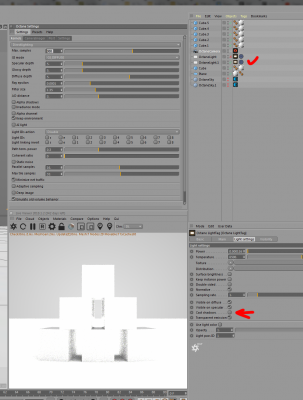

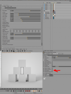

Hi all!
Think that's a bug - Strange behavior with unchecked Cast Shadow feature in OctaneLight.
Picture looks overexposed with no matter of power strength is set to light source (2nd and 3rd sreenshots)
One more strange and not-like-in-a-real-life - OctaneLight gives a shadow even without luminocity? Please, look at the first (wide one) screenshot.
May be I'm wrong with something?
Thank you
P.S.: thanks for clean shadow pass with render layer. Finally
Thank you
