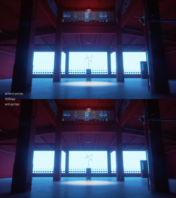

Hi, adding portals to the scene significantly increases the noise. Did you plan it this way or is this another flaw?
Cinema 4d integration.
HHbomb
Posts: 1387
As the two renders are almost identical except noise, why do you use portals ?

HHbomb wrote:As the two renders are almost identical except noise, why do you use portals ?
I saw this guys post the other day and thought the very same thing... those renders are almost identical, the area near the central hanging lamp is slightly brighter, that's all to my eyes.
Perhaps he is using them incorrectly.
