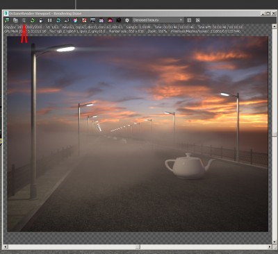

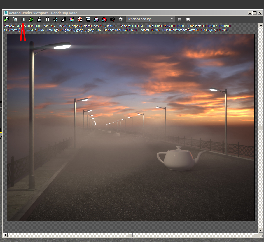

Since I rendered the finals out of the scenes with geometry the only "bug" I had today was the non working denoiser. All checkboxes were checked and I clicked it some times but denoiser just didn't kicked in. Of course I selected the denoised beauty pass.

Hi mbetke,
did you check in Octane camera and in device pannel?
try activating cpu memory
Regards
Paride

mbetke
Posts: 1306
Location: Germany
No crashes. I now checked "denoise on completion" and then it works. One GPU used for Denoise, the other one for Tone-mapping.

Posts: 3997
mbetke wrote:No crashes. I now checked "denoise on completion" and then it works. One GPU used for Denoise, the other one for Tone-mapping.
Hi mbetke,
this issue should be fixed simply checking/unchecking or pressing rebuild geometry.
Regards
