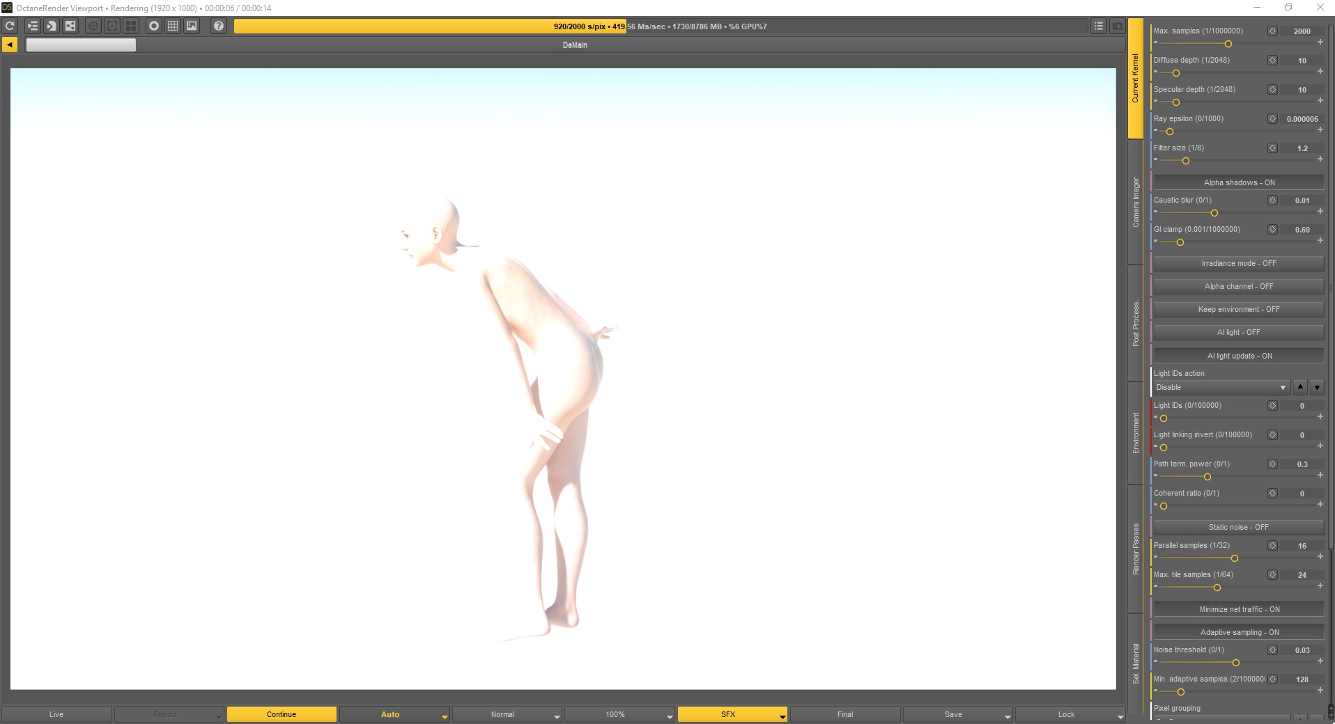

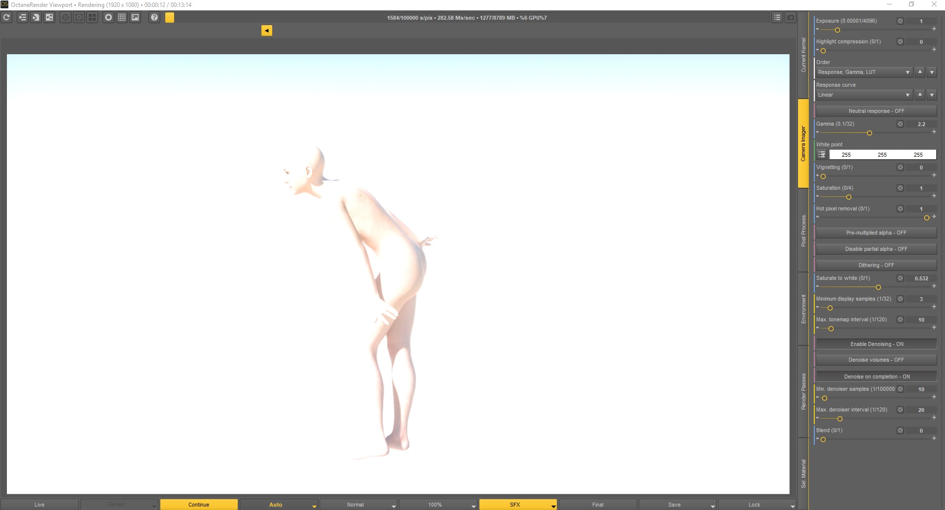

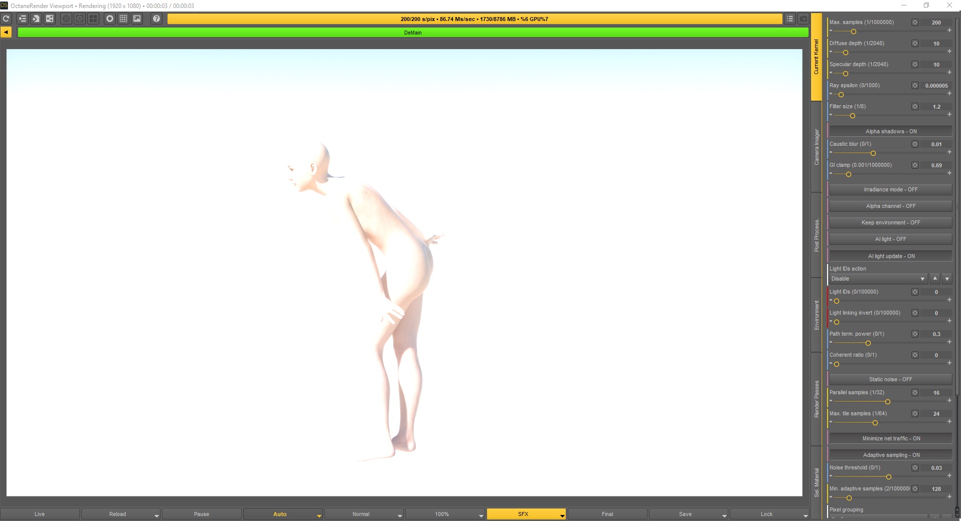

Check the denoiser setting on the image (image1). As far i understand it should start denoising at 20 samples. Fact is ... the denoiser doesnt kick in at all.
The only way to make it work is to set !denoise on completition to ON! and set samples to a low value like 200. Then it denoises the image at 200 samples and stops rendering Image2). If i turn the samples after it denoised to a higher value ... like 2000 it steady denoises the image after a certain amount of samples till it reaches this 2000 samples at the end. (image3)
I suppose it should look and work like you see on IMAGE 3 without this step in between (limiting to a low samples count and seting this value up again)
This happens always and with every scene. I suppose this is why valzheimer is thinking the denoiser doesnt work for him.
I think Octane Standalone works this way too. I do not see a denoised result until the end of the render (as far as I can tell).
