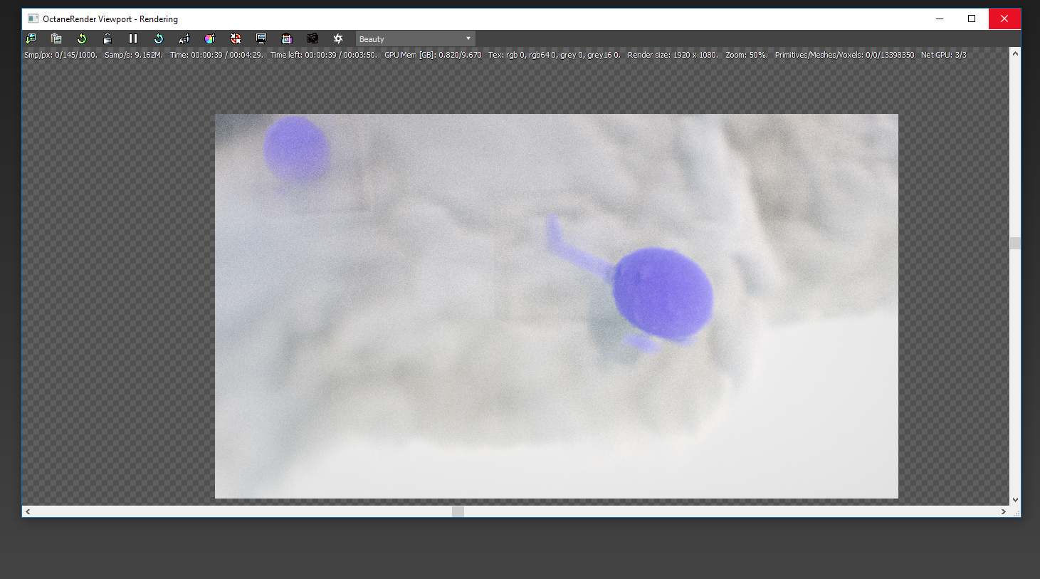

coilbook wrote:I just want to say that there is still a problem with overlapping VDBs. In our case one small vdb is inside vdb cloud. The same step length but you can clearly see vbd border of a blue vdb helicopter. Hopefully you can look into it.
Can you send me an orbx with these volumes in that setup please?
hi here is the scene with vdbs In this picture you can clearly see vdb box around the helicopter that leaves imprint on cloud vdb. For some reason octane treats empty grid cells as an object that distorts another vdb box. Vray does not have this problem with overlapping vdbs.
here is a post about this on phoenix forum https://forums.chaosgroup.com/forum/pho ... e-the-grid
Chaos said it is octane limitation. Hopefully you can fix it

coilbook wrote:
We'll look into it. We already have some changes in mind. For now if you decrease the step length of both helicopter and cloud, the border will go away. We have ideas on how to avoid doing that.
