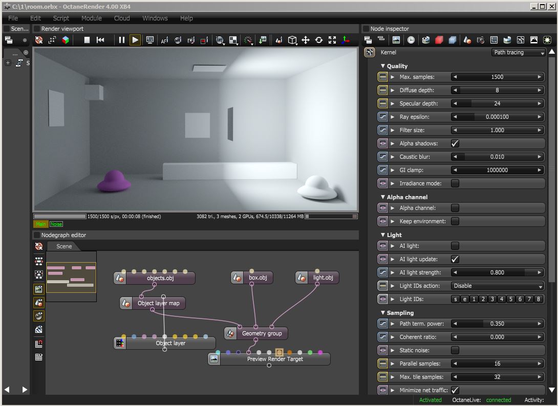

Otoy - could you please fix the "Shadow visibility" when lights are bouncing? It still cast shadows from indirect lights. Not the first time I mention this, but nobody has given any answers to this major problem yet.
Here is a scene with 1 light and 7 objects. 2 of the objects is in direct light while the objects behind the light source get the indirect light from the bouncing lights on the walls.

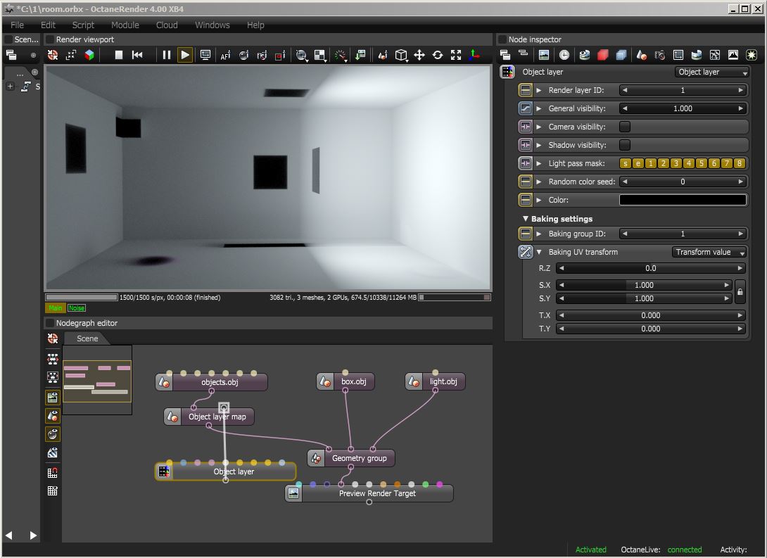

And here with camera/shadows visibility unchecked.
The objects behind the light source still have full shadows. The object in front has not. Well, they have a little from the indirect lights. But if you would set the Diffuse Depth to 1 so there's no bouncing light, you would not see a trace at all from the objects in front of the light.

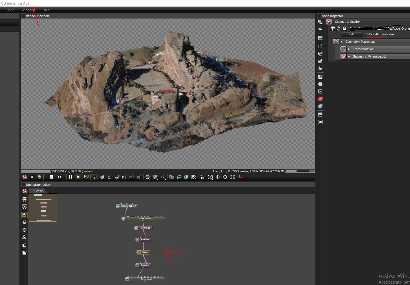

I am making some sort of point cloud rendering in octane using scatter node.
I can easily load over 10 millions points in octane 3 but no way for v 4, even with out-of-core turned on. Please tell me that will be fixed.
The dream for v4 may be to be able to handel 1 billion instance or closer.
I deal with billion of photogrametric points from time to time at work.

Is it a render failure or Octane crashes when you try to render? Are you running out of VRAM in v4?
hi haze,
I get a gpu failure in both out-of-core on/off, octane v4 xb4.
Octane is not shutdown.

Ok. Would you be able to upload the scene to dropbox or somewhere I can download it so I can take a look?

Zay wrote:Talking about shadows.
I talked to Marcus about it, currently this is a limitation of the system. There are ways to change this, but to determine which way, we would need to know what it would be used for - can you give us an example in your workflow where you need this (for our understanding)?
In the mean time,we will fix the tooltips on these settings to indicate that they operate only for direct light.

haze wrote: There are ways to change this, but to determine which way, we would need to know what it would be used for - can you give us an example in your workflow where you need this (for our understanding)?
I use it all the time for indoor scenes. On walls, doors, ceilings, windows - where ever I need a fill light and its reflection. Especially for wall lights to assist in various ways.
But - the problem is also in the Octane Environment/HDRI.
