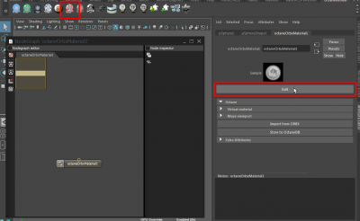

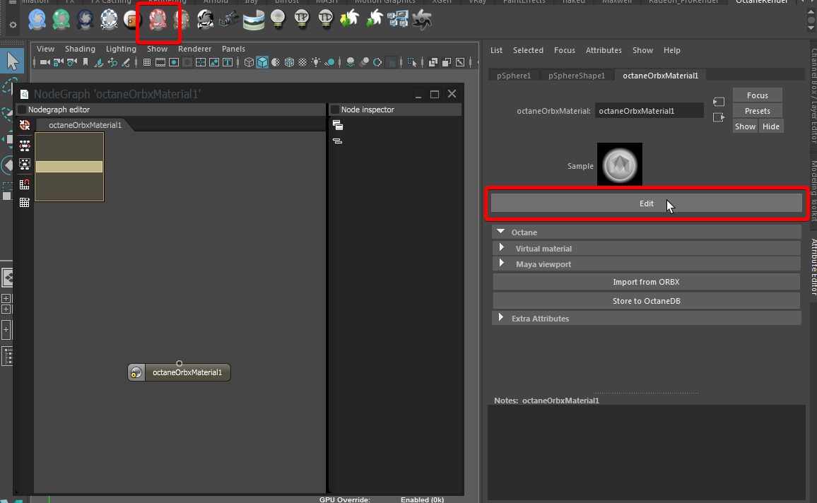

calus
Posts: 1308
Location: Paris
p3taoctane wrote:I think what you mean by that is you can make the materials in the stand alone and import the ORBX file.
Bikram refers to the new ORBX material node in Maya (red shaderball button in Octane Shelf).
In this node you can either import the material from an external ORBX or create it from scratch directly in Maya but with Octane Core UI component:
This is very nice, IPR update in realtime while creating/editing the octane shadregraph.
But still have some flaws :
- pay attention that what you do in this UI is only saved in the scene when you close the window.
- This octane UI node-graph doesn't stay on top of the Maya UI when you clic outside, so it's easy to loose this window hidden behind the main Maya window.. (so also forgeting to close it to validate the change)
- You can't create an ORBX material node directly from live DB.
Pascal ANDRE

Posts: 1418
Joined: Mon Jan 25, 2010 12:53 am
Quick play around... I love it. I agree with previous comments.
Its hidden and not only that it has to closed to be set in the hypershade on first creation.
It would be nice to be able to double click on it in the hypershade and it automatically opens in the ORB editor.
It would be super nice if there was a mini preview window for just the material in the orbx editor window that pops up.
Rather than assign it to an object and edit it when its rendering it would be nice to just render the material before assigning it to anything.
I am sure you are working on these things and more... but this to me is a very nice feature.
