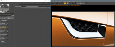

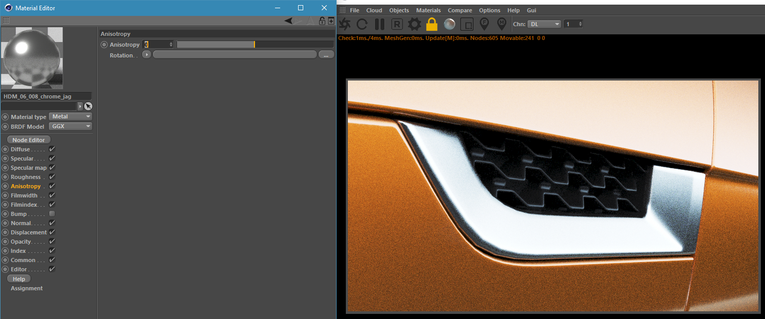

]Hey Aoktar, thanks for the version.
I could be mistaken but it seems like something is wrong with the anisotropy slider after convertig glossy to metal materials? Only after manually changing and setting it back to 0 it´s actually zero.
*It´s nothing major, just something that at first made me think something is entirely off with the materials ;)
converted metal with 0 anisotropy
converted metal after manually changing anisotropy to 0

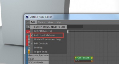

mesut wrote:hi,
great update. thx.
i believe to have found a reproducable crash:
1. add light(sky, hdri... whatever)
2. add sphere
3. add octane-material to sphere
4. render in live viewer
5. open node editor of said material
6. connect a node (i.e. rgb) to diffuse
7. delete octane-material from material manager
8. freeze/crash of c4d (the one that shows you a "thinking" circle)
EDIT:
i tried this again, but this time with a "checker"-node instead of rgb... which led to "normal" crash with bugreport and such.
here's the zip, containing everything the report produced:
http://www.mesutcapkin.com/temp/complete_report.zip
Can't reproduce it! But be sure that you have enabled parameter as in picture.

Savi089 wrote:]Hey Aoktar, thanks for the version.
I see that. There's a glitch on codes. I'll fix it for next, thanks!
