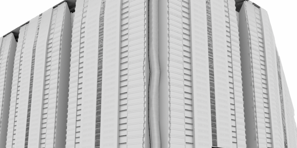

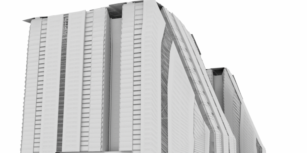

I agree, it would be great to have the option to keep the continuity or not and choose the blending angle.
In the example I'm showing, the UV are straights and I have a bit of subdivisions. I almost prefer the render with the previous version and the gaps.
Hopefully you can fix this :)

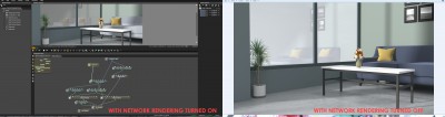

I just updated from 3.07 test 6 to 3.08 test 6 and I'm having an issue with one particular material I'm trying to use. The material is a fabric created with a mix material, diffuse, falloff, jpgs, displacement and color corrections. When I turn on Network Rendering the material starts off with the blue color I've assigned it but as the samples grow the material turns white. However, when I turn off Network Rendering it renders correctly. Any idea what could be causing this?

RSC wrote:I just updated from 3.07 test 6 to 3.08 test 6 and I'm having an issue with one particular material I'm trying to use. The material is a fabric created with a mix material, diffuse, falloff, jpgs, displacement and color corrections. When I turn on Network Rendering the material starts off with the blue color I've assigned it but as the samples grow the material turns white. However, when I turn off Network Rendering it renders correctly. Any idea what could be causing this?
This has cropped up a couple of times in the C4D beta release forum too, looks like something to do with network rendering and mix materials?

Thanks for letting me know. At least now I know it's not something unique to my scene.
