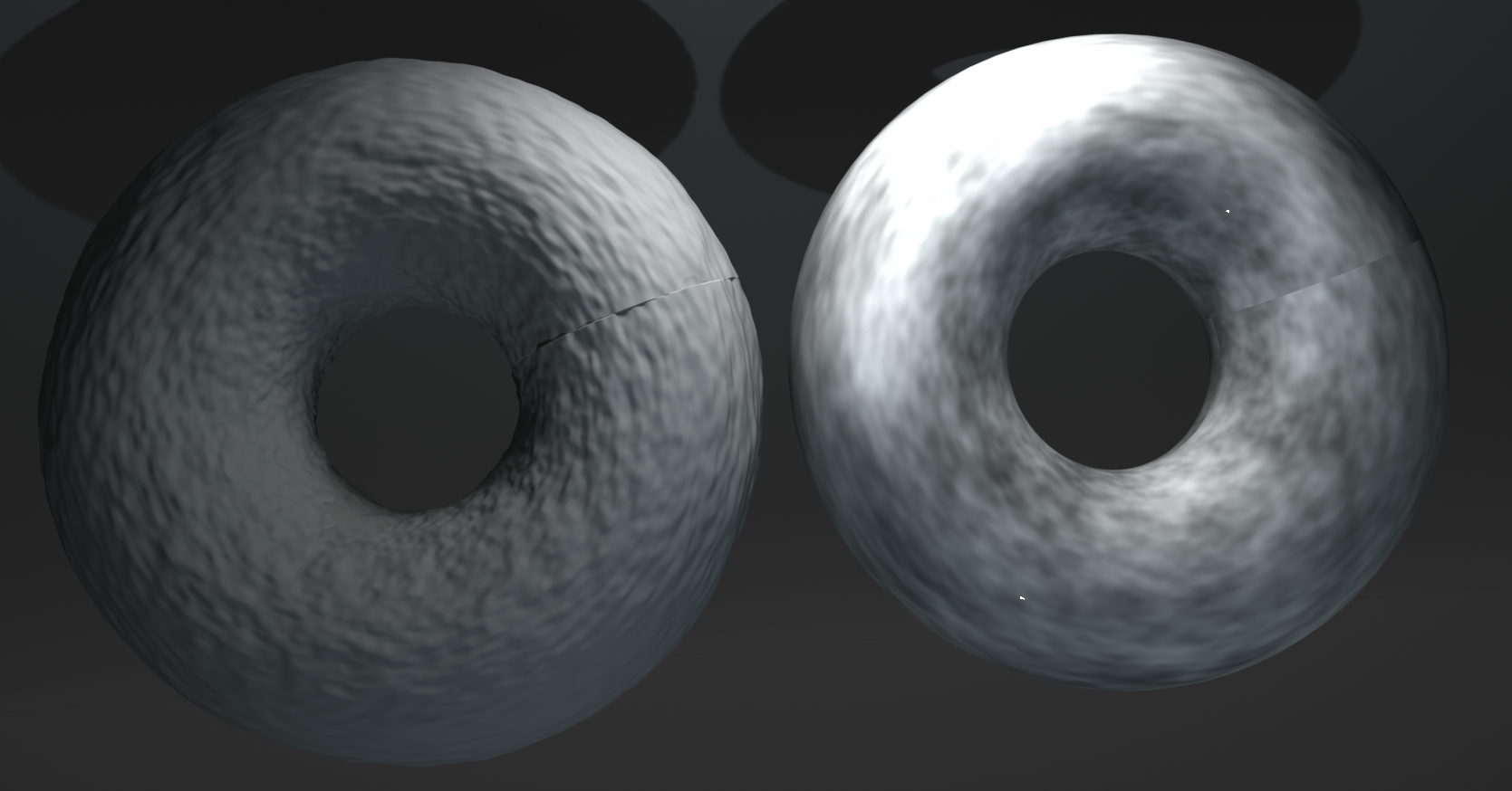

left Torus is displaced by a baked 3D noise, right Torus have the same procedural texture but in diffuse.
octDisplace.orbx
(146.31 KiB) Downloaded 396 times
The noise is an Octane noise connected to a bakingTexture to be sure that the values match at UV boundary,
but we can see displaced values are not matching, creating the gap,
also the baked noise is clearly stretched along U,
the wrapping from 3D space to UV space is wrong so this is the reason of the Gap,
or is it a limitation = only proportional UV map are supported ?
displaying in right Torus diffuse the 3D noise going trough the bakingTexture node I can confirm the problem is not in displacement but in the bakeNode, or I am doing something wrong ?

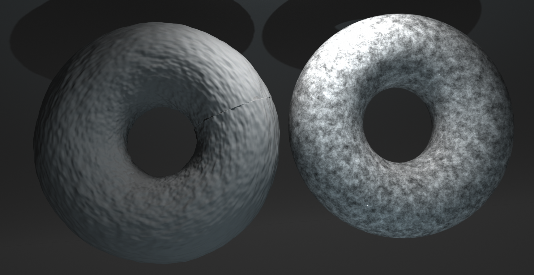

Hi Abstrax,
Yes I think for the feature to be useful we need to be able to bake on the Mesh UV any type of projections into mesh UV, Is true is baking only mesh UV to MeshUV and this I think is strange, is some cases we want bake this type of projections.
Here the same scene with the Idea only using diffuse channel.

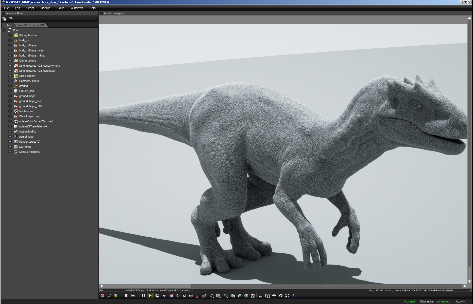

Hi Abstrax,
Thanks for the fixes is working pretty well now! the normal fix is great, also much better stuff with the other texture still the gaps on the uv seams, I guess you guys still working on close the gaps?? but I've got better results, I have some issues on the eyes and feet when touch the ground but i will try to subdivide a bit more the base mesh I guess?
here I set the base mesh the low poly with no subdiv :) just wow! awesome.
Thanks for the hard work.

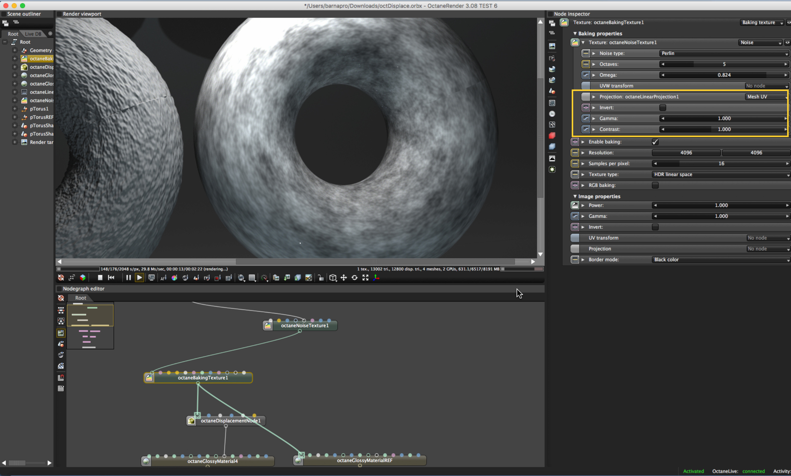

Hi Pascal,
in your scene, the Baking texture projection is set to UVW-Planar mode, so it is not uniformely wrapped on the torus.
If you change the Projection to Mesh Uv, and connect the Baking Texture also to Diffuse, here is the result:
The texture is distributed in the same way, and you can see the little gap in conjunction, because the baked noise is different in the borders, but it’s an expected behavior, and obviously the procedural noise does not have this kind of issue.
Hope that it make sense.

Arg, my scene must be confusing because of the displacement, so you missed my point I think.
This is the procedural noise that is using XYZtoUVW projection, not the BakingTexture node, the bakingTexture node use UVprojection.
And this is on purpose, because the point of a bakingTexture node is to convert a texture from a projection space to the UV space, else well this is a useless node that can only bake texture from UVspace to UVspace :shock:
So do you confirm this is a limitation of the bakingTexture node ? (only support UV procedural texture as input)
But in this case I think it's a bug because using different projection for the input procedural texture I get different with very weird projection...
