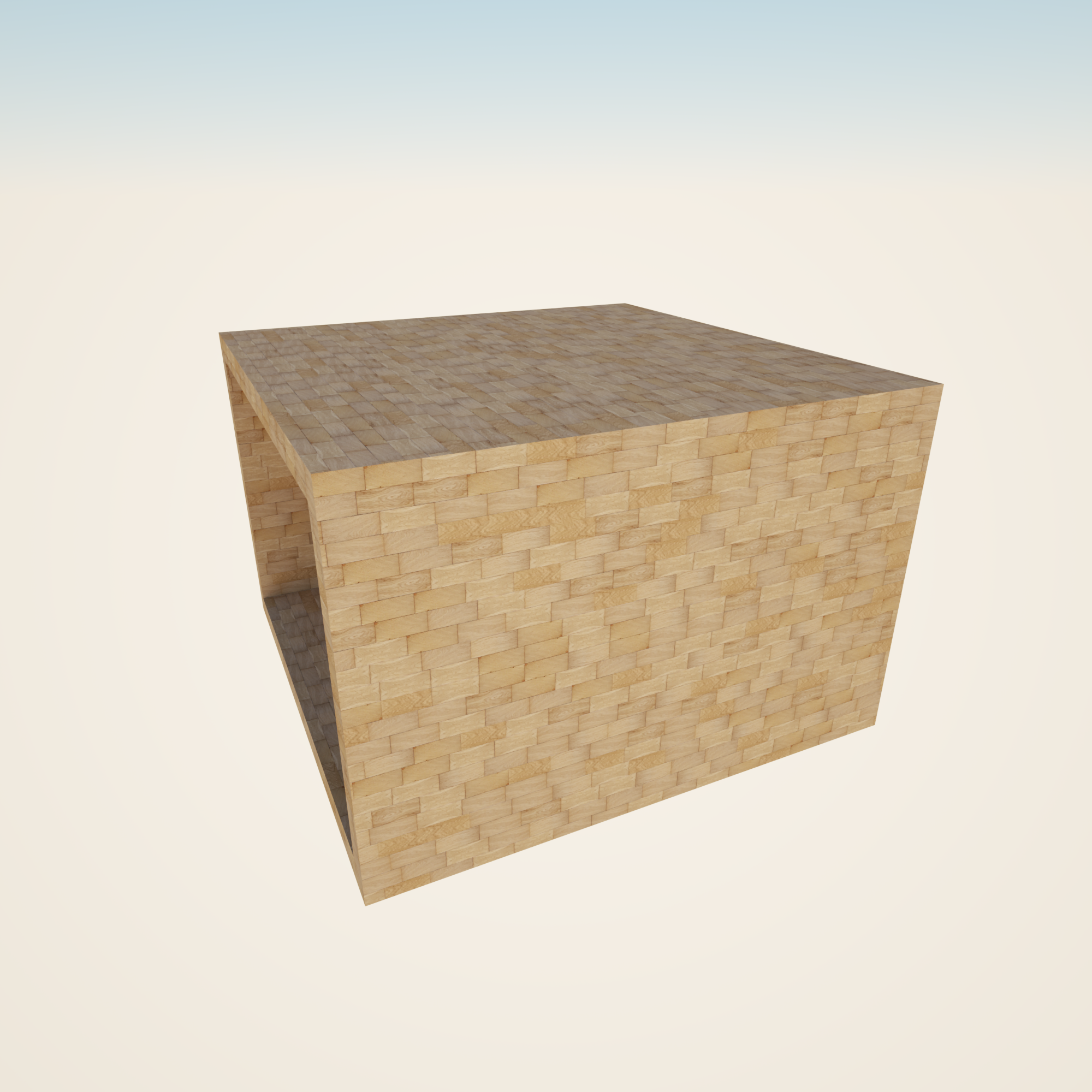

thanks Roeland, this works!!!
cannot wait for this to run in my Rhino plugin...
my problem is that I am a little bit of an illiterate when it comes to coding, so I dare to post two additional wishes:
1. As I understand, right now the row offset is purely random, can you implement an option to make a fixed offset for every n row, so e.g. a) 2 row loop, 1. row +0%, 2.row +50% b) 4 row loop 1.row +0%,2.row +30%,3.row +40%,4.row +5%, so the user could define the number of rows until the pattern repeats, and the offset for each row?
2. Wish (I know, this is probably much harder to implement...) if we could add the possibility to define an "gap " between the tiles , which would be filled with a second material (e.g. mortar) we would have a very mighty brick simulator !

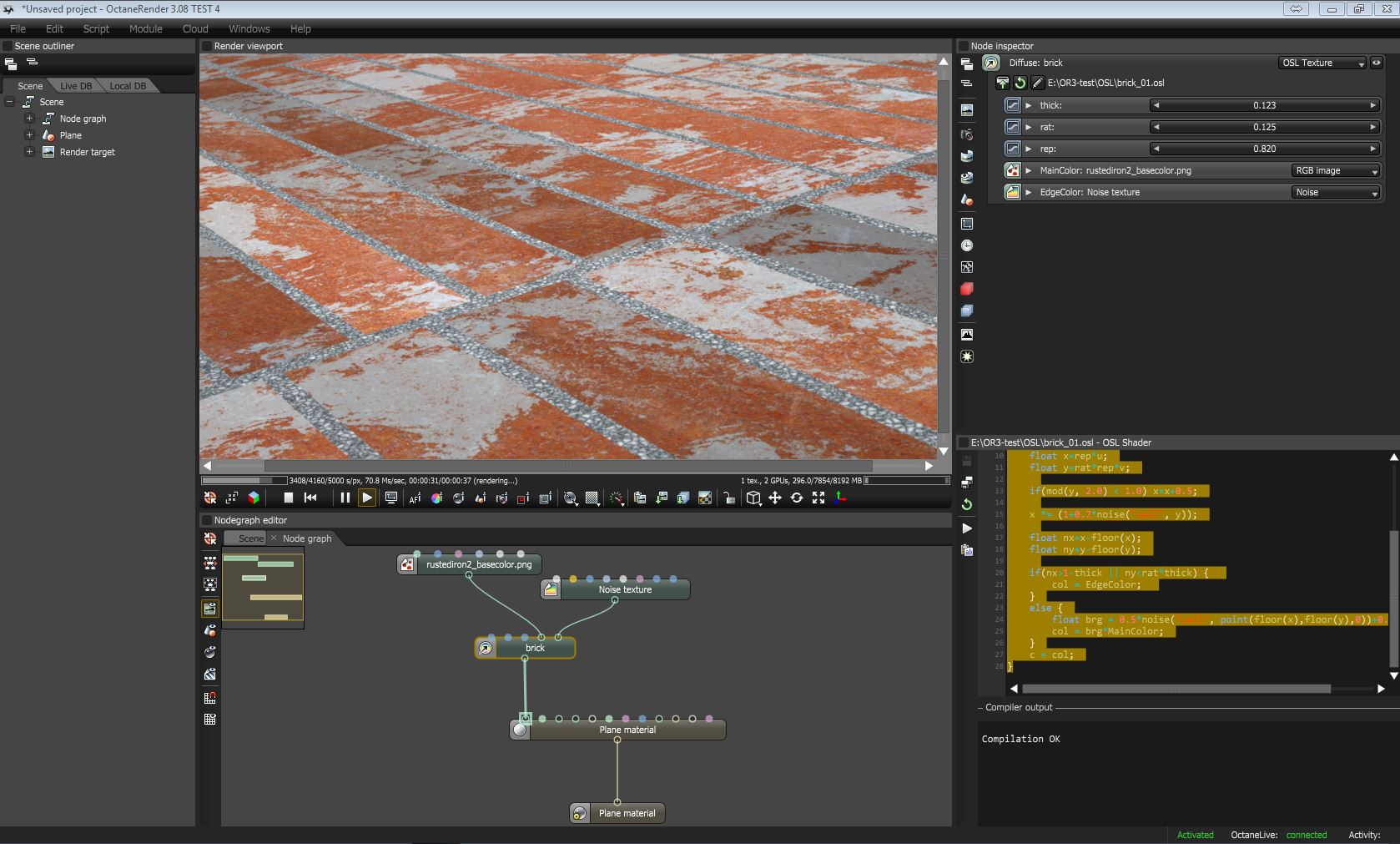

Hi Andreas,
it's a different approach compared with multi texture, but try with this version:
Code: Select all
shader brick(
        float thick=0.05,
        float rat=0.6,
        float  rep=2,
        color MainColor = color(1,0.23,0.13),
        color EdgeColor = color(0.9,0.9,0.9),
        output color c = 0 )
    color col  = MainColor;
    float x=rep*u;
    float y=rat*rep*v;
    if(mod(y, 2.0) < 1.0) x=x+0.5;
    x *= (1+0.7*noise("cell", y));
    float nx=x-floor(x);
    float ny=y-floor(y);
    if(nx>1-thick || ny<rat*thick) {
        col = EdgeColor;
    else {
        float brg = 0.5*noise("cell", point(floor(x),floor(y),0))+0.3;
        col = brg*MainColor;
    c = col;
ciao beppe
