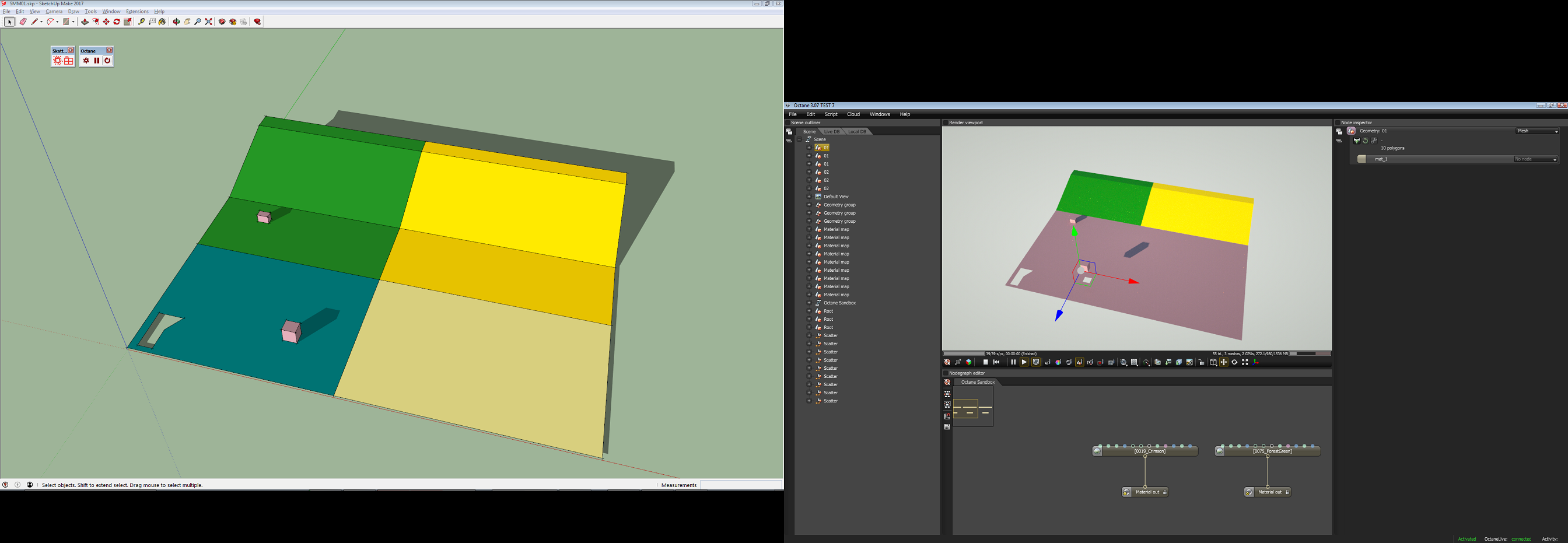

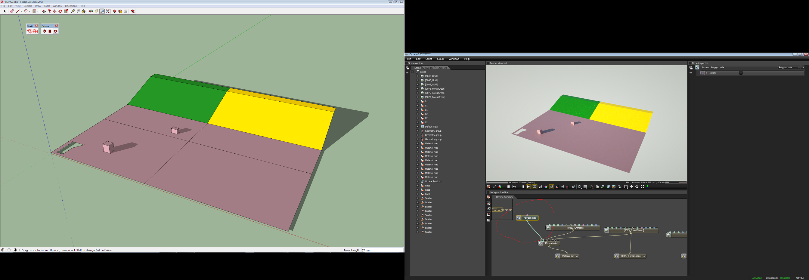

Don't use skatter and proxies, but still it crashes a LOT. Using "create material" are unstable, using predefined are more stable (now i only use "Colors-Named").
This bug are annoying. Super simple geometry, and still it doesn't update materials and geometry. I think it's related to Window/hole cutting and the "self healing geometry engine" in Sketchup.
The two cubes are generated from two Push/Pull faces. And then I painted four color patches.
SMM01.rar
(27.92 KiB) Downloaded 427 times
Win7 Sp2____2xGTX1060 [email protected]____Su17.2.2555 and Su18.0.16975____SketchUp Plugin 4.00.0.17____4.00.RC7 Standalone
johlanga
Posts: 146
Joined: Fri Feb 01, 2013 2:58 pm
Ahhh....the hole cutting bug and color are not related. It's double side materials in SU. My mistake :)
Is it possible do have the pluggin respect double side materials with "Polygon side" node?

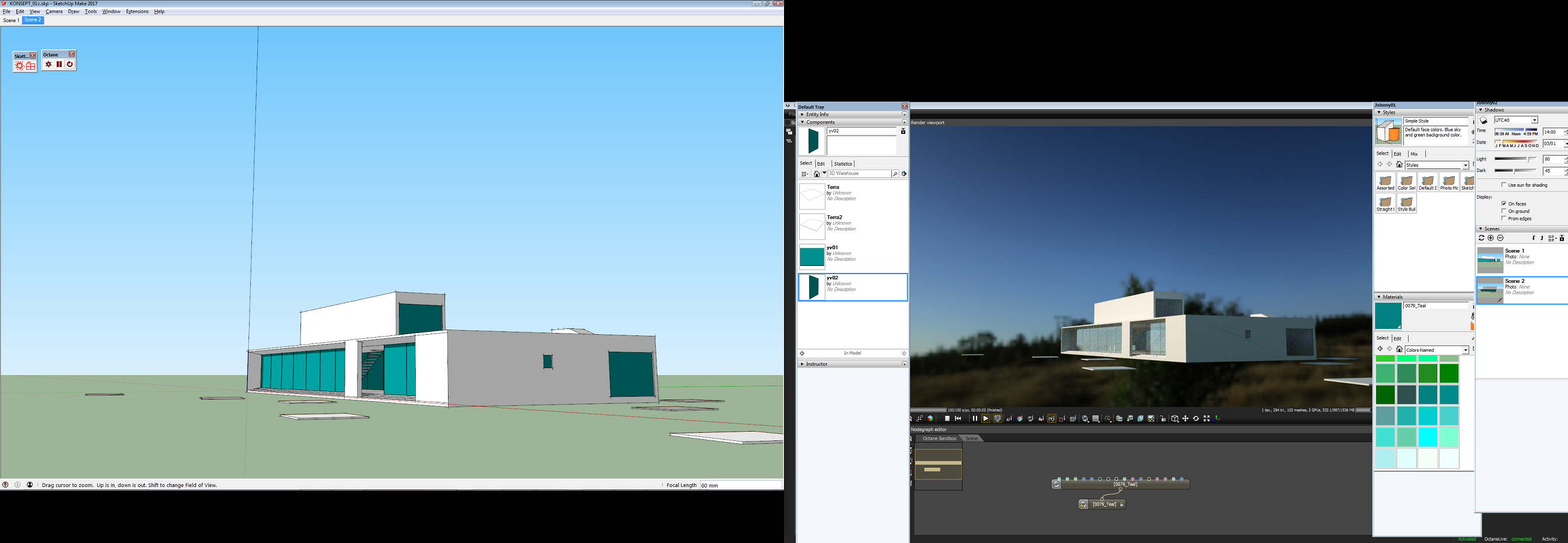

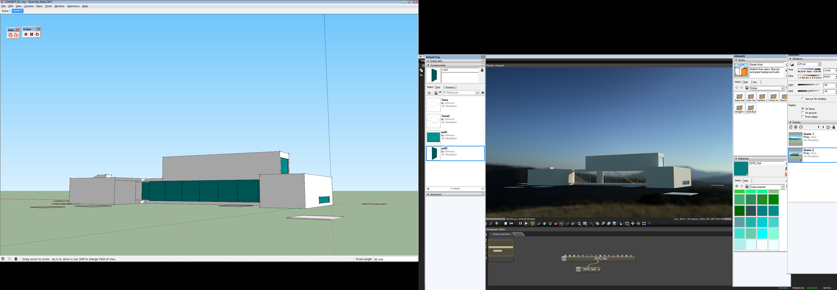

Sure, the setup are quite simple.
NB: the project are a long term case and has no deadline, but a possible presentation somewhere on the horizon. I use octane for SU as a sketching tool in parallel with a sketchbook.
-White box to push pull (a lump of clay to get the design going), no material assigned.
-One component, big windows. Specular material and no cutting/gluing.
-One component for windows in part of design secondary functions (typical smaller windows)
This one has cutting opening and gluing and a big depth to illude a room behind window.
The windows are minimalistic so scaling every size is OK.
