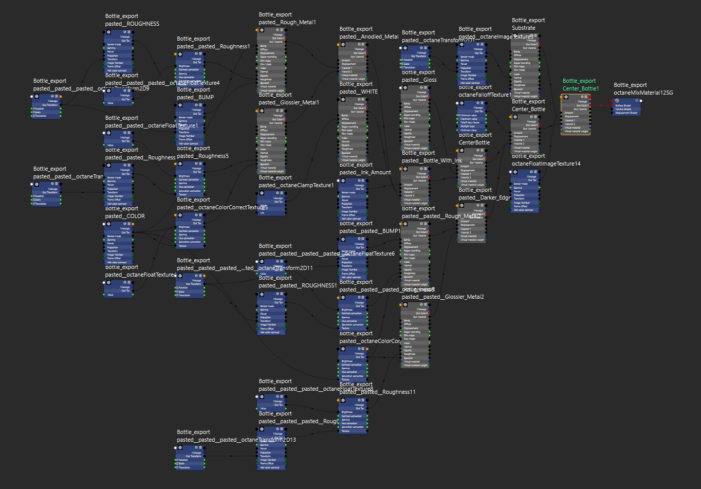

i've already had to revert back to a former version so I can't do any real testing at this point. There may be more to it but as best I can gather this is how it went down:
1. make a scene with textures in it, in a version earlier than the current 3.06-10.19 "stable" version.
2. save
3. close
4. open in current 3.06-10.19 "stable" version
5. try to render and some materials randomly render white, as if octane thinks there was a lambert applied an not an octane material
**bonus: if you try and update the material thumbnail, the thumbnail doesn't even render. weird garbled lines show up as a thumbnail.
reloading a texture fixes the problem...but...
no way in hell i'm going through a node graph like this to manually reload every material, as a quick fix....

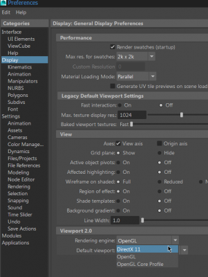

renmaxhb wrote:Material lost textures allways when open a maya scence, the poly is defaut material, must click the texture reload button every time.
itsallgoode9 wrote: no way in hell i'm going through a node graph like this to manually reload every material, as a quick fix....
This bug is triggered by the viewport Material/texture display (Yes you read right, a viewport issue triggers a render bug :shock: ...)
The workaround for this bug, is to use a viewport 2.0 mode that is not supported by Octane texture display
-> so you will have grey display of Octane Material in viewport 2.0 but no bug at render time
WORKAROUND = set the viewport 2.0 mode to DirectX or OpenGL Core Profile.
more information on this bug here:
viewtopic.php?f=110&t=60965#p312981
