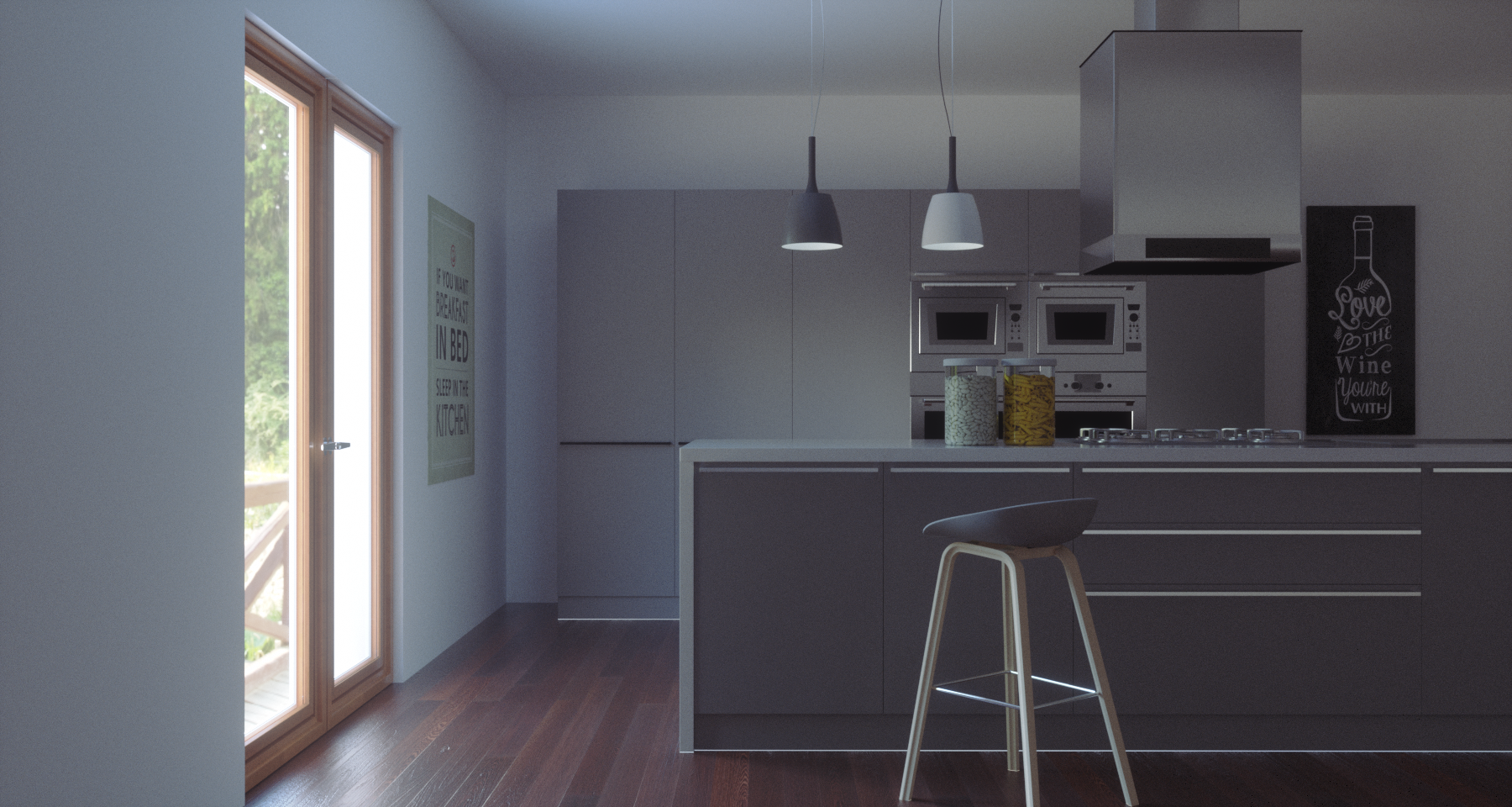

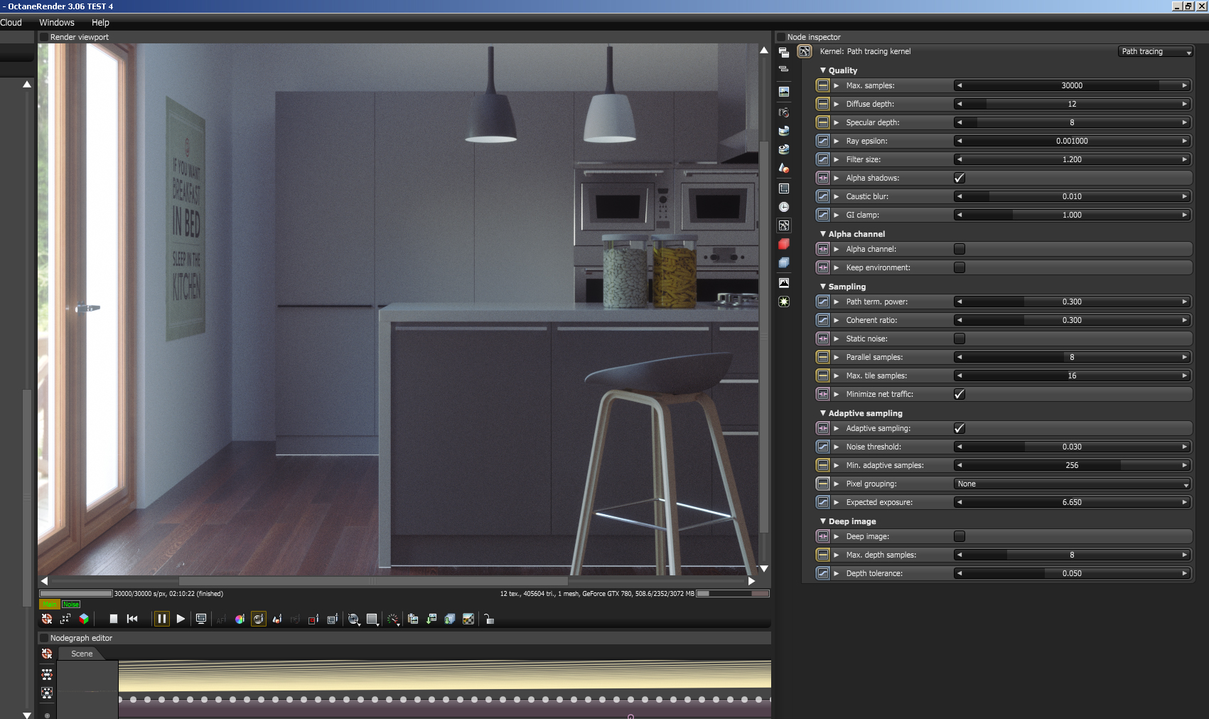

HEre something I need help and in many situation like this..
I got this very little scene as testing BUT I get awful lot of noise still after 25000 samples and I did try my best to down he power of the HDRI and optimize Path Term to 0.3 and set AS to 0.03 ( but even 0.02 did not change much ) 2 Hours and still that noise in dark areas, I don't know were to light somewhere in the room but I wanted the light to enter only from the window as it is my intention to do..

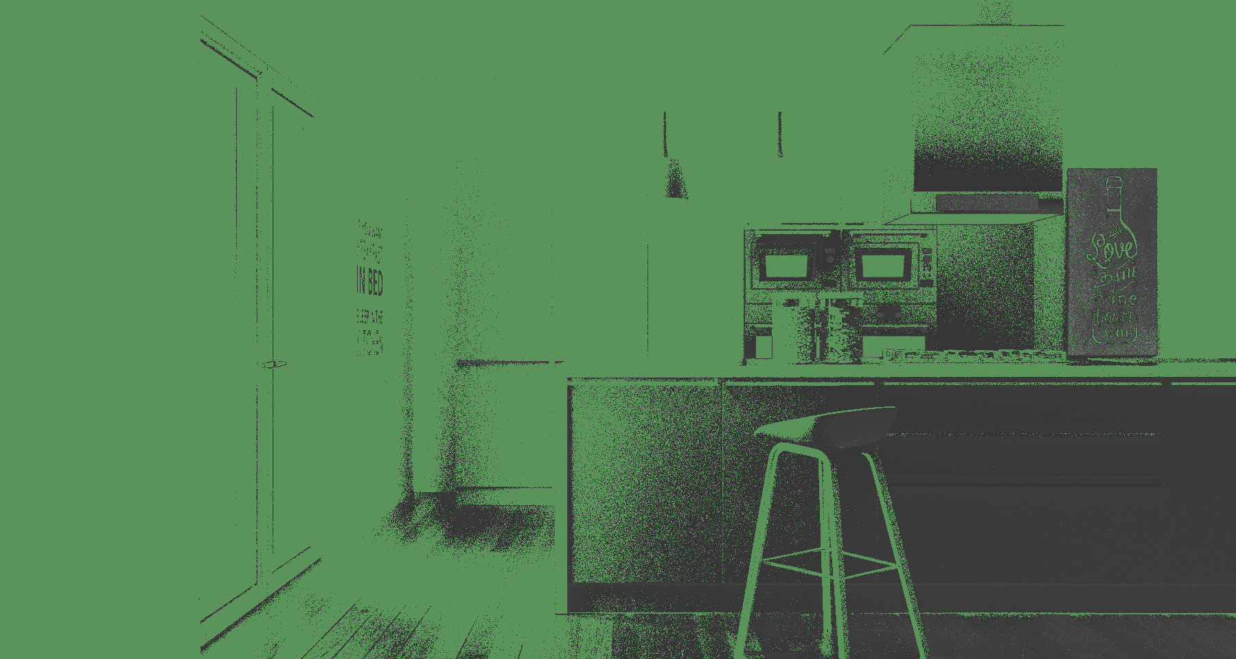

When I do set renders without a proper room box ( unlike just using a wall and a floor ) I get Noise from hell and I would like to optmize the matter , I thought AS could help in Cutting it down quicker but it does not sems much help, I post my settings. see the noise map seems almost done but not completed at 0.03..
Any tips? Also Response does influence and usually I never use Linear as it look too washy..
Thank you
Win 7 64 | 2 X MSI AERO GtX 1070| Intel I7-6850K| 32 GB DDR4 RAM | Asus X99 II-A
smicha
Posts: 3151
Location: Warsaw, Poland
Path term power 0 for shadows. Coherent may be higher. Caustic blur 1.
Tile and parallel set to max for better speed.
AS 0.03 may be too high. Min adapt. samples - try double it.
