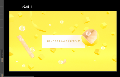

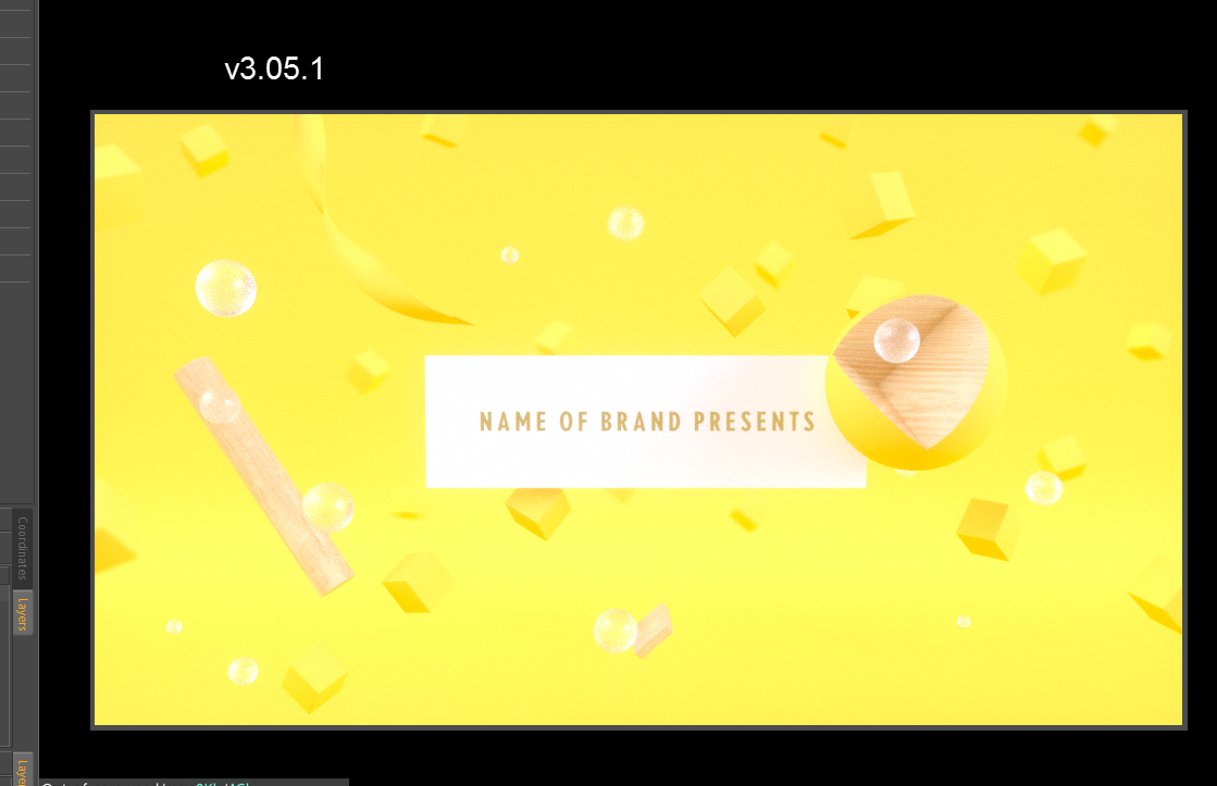

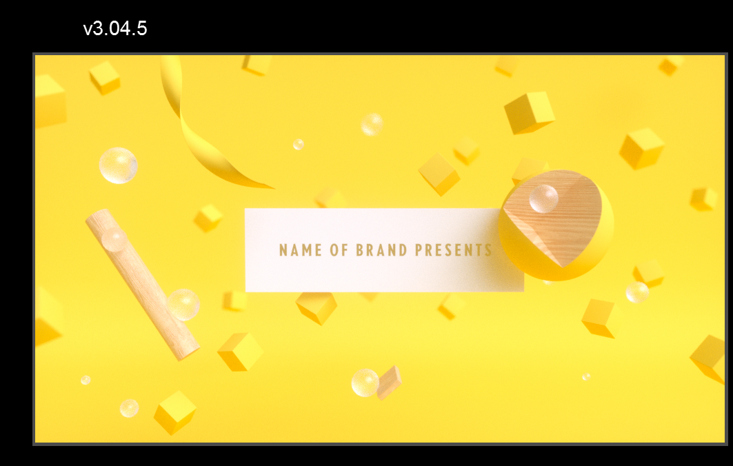

Just did the update for this version. and the render looks different on live viewer from 3.04.5 (C4D R18)
i Didnt changed anything. just moved between versions and the result attached.
Any idea?

I found out that in this Version, you have to put a "+" or a "-" before your X Rotation in the HDRI - because its changed. Is it right ?
Because I had the same problem like Yambo and could figure out that its the X Rotation.

Every hdri in a environment object seems to be rotated or better said mirrored!? In X you just have to put either the negative or positive value to get the same light like in the older version.

Ok thx no problem! We have checked that. There is some mirror effect for environment textures in latest sdk. Arturo is checking that and propably they will prepare a fixed sdk next week.
