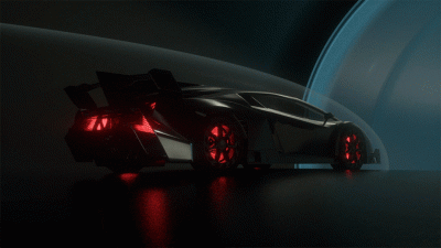

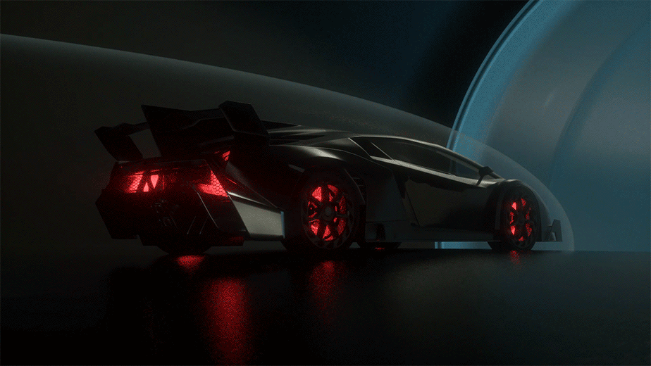

- also found something buggy with motion blur - first some of my rotating objects were not showing, like 1 out of 4 wheels didn't show on one pc, and 4 out of 4 wheels didn't show on another PC..
- then copy pasted the same geometry onto same place and deleted old, and it worked.,
- but now, I render it out, and discovered that the rims are animated like they have offset centres.. which is also visble when activating/deactivating motion blur .. so a bit of chaos happens when using motion blur, like it moves the object around, or the center of the object..
- is that documented or new?
check out the attachment .mp4.. it's running perfectly in the viewport, and as far as I can tell it runs OK without the motion blur - now rendering without the motion blur thing

PS this gif (press to play) is from the previous animation only now without motion blur activated - not sure what was the issue previously with wonky motion blur, didnt fix at , this was from a fresh scene in 2017, with merged geometry from max2015, which had imported geometry from maya - probably fbx (I used the send to max in maya) - anyways, it was pretty clean considering the mess I usually work with

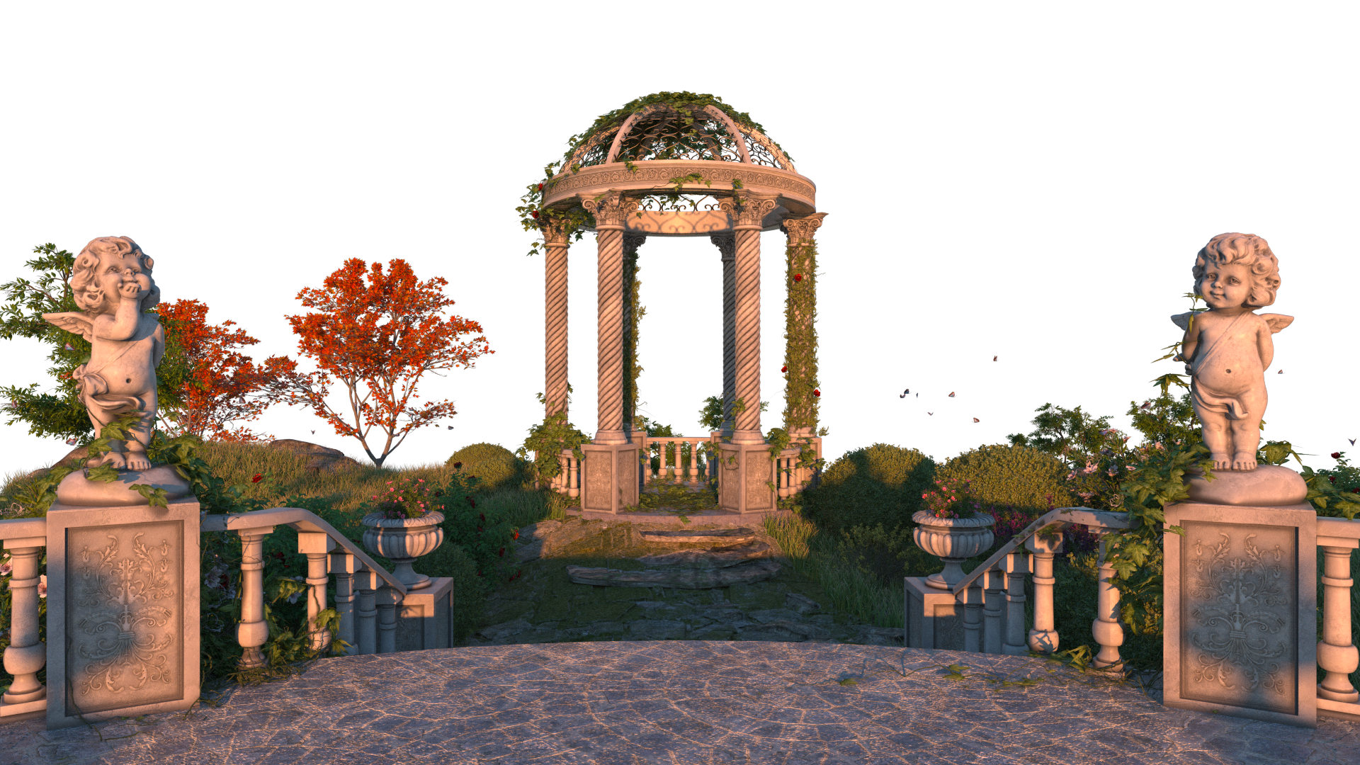

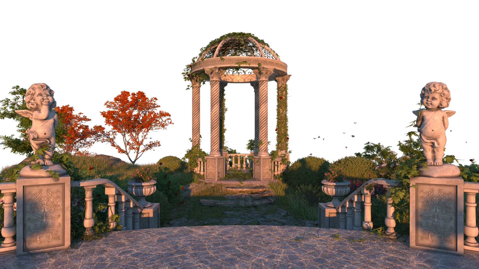

sequentia does not work, I have animated trees, on which they render static
