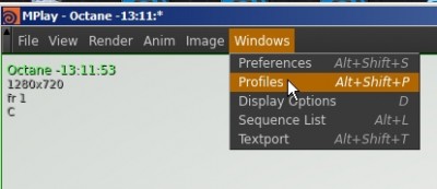

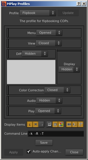

You only need to add the "-T" option in the MPlay profile command line options. Once done the MPlay window will stay always on top, and updating the scene changes. Not all changes can be updated yet, for example if you add a new object (to reload the scene in this cases, you only need to press the IPR button again).
MPlay menu: Windows->Profiles->Command Line
