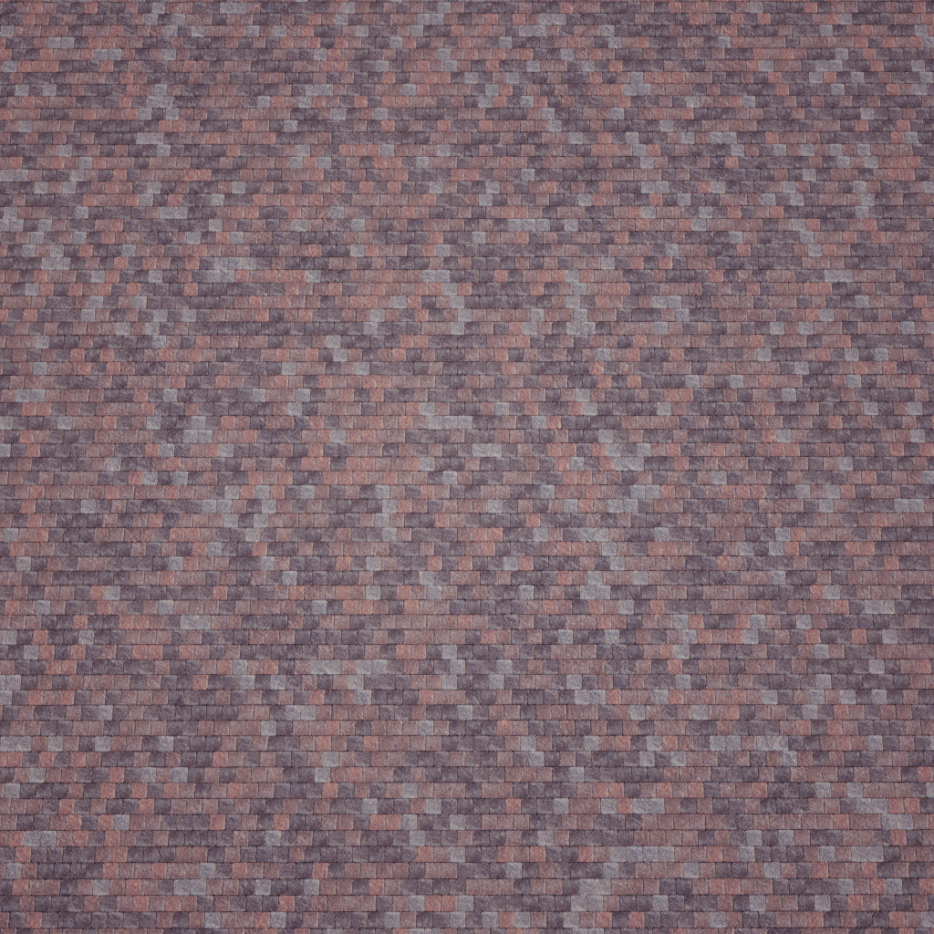

Would it be possible to create an Amount and Scale input for the scatter node? I would like to reproduce a texture like this on a big surface
Actually OSL should be able to simulate this I think
Octane 2022.1.1 nv535.98
x201t - gtx580 - egpu ec
roeland
Posts: 1826
Yes, this can be done using an OSL texture: You can start from the laminate example here: viewtopic.php?p=326508#p326508
Set the plankAspect to 1.0 for square tiles.
However, this shader will generate a random offset for every row of tiles. To get a regular pattern like in your picture find and replace the lines
Code: Select all
    // random offset for each row
    float x = p[0] + noise("cell", y, 0);
with
Code: Select all
    // alternate offset for each row
    float x = p[0] + 0.5 * ((int) y & 1);
whersmy
Posts: 723
Joined: Thu Aug 30, 2012 7:40 am
Getting there! Is it possible to add a random rotation for the square planks/tiles? In practice you would only need 4 options, each 90 degrees turned. In order to get the right irregularity for now I solved it roughness.

Share the scene please - great job.

Here we go. Usable for buildings as well if displacement is not necessary.

roeland
Posts: 1826
Yes. The script as it is contains code to randomly rotate the texture by 180°:
Code: Select all
    int flip = (rnd - floor(rnd)) < .5;
    // make UV mapping per cell and evaluate the right texture
    float plU = x - floor(x);
    float plV = y - floor(y);
    if (flip)
        plU = 1 - plU;
        plV = 1 - plV;
We can extend this code: for instance this randomly picks any of the 8 combinations of rotation (0°, 90°, 180°, 270°) and mirroring.
Code: Select all
    int flip = (int) ((rnd - floor(rnd)) * 8);
    if (flip & 1)
        // flip U
        plU = 1 - plU;
    if (flip & 2)
        // flip V
        plV = 1 - plV;
    if (flip & 4)
        // flip over diagonal
        float tmp = plU;
        plU = plV;
        plV = tmp;
