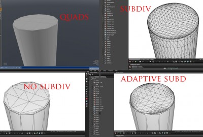

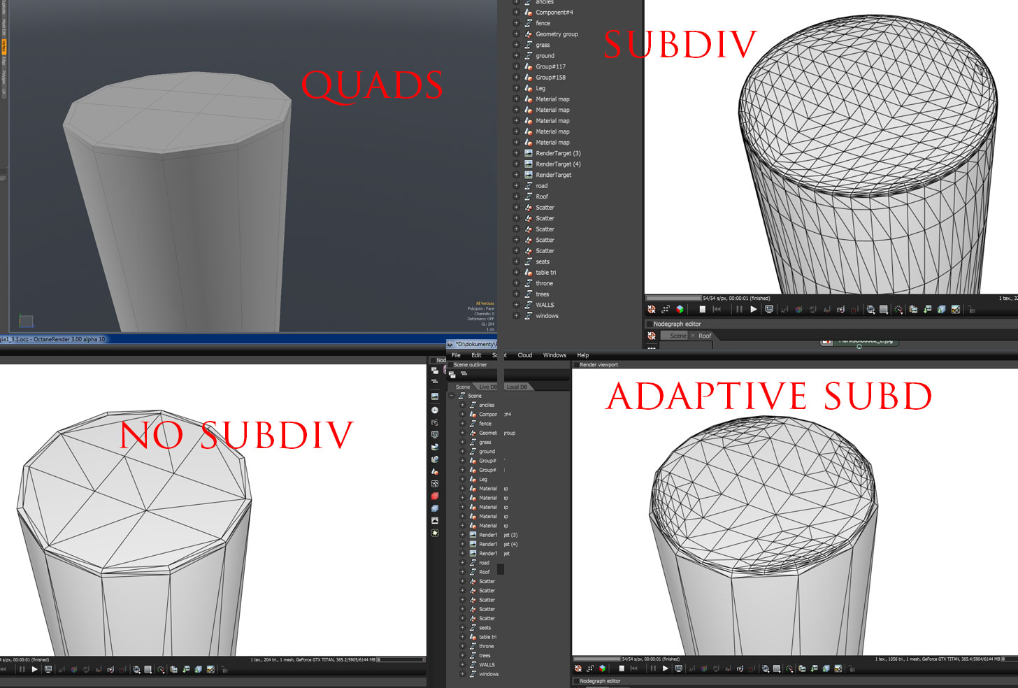

Marcus,
I join the questions on adaptive subdiv. Is there any chance we had the adaptive subdiv. levels working as a function of distance from an object (nearest instance) to a camera? But keeping same way of subdivision as it currently works without adaptive on? Being very honest I don'y see any application for current adaptive function, or I am missing something.

smicha wrote:Marcus,
I think you're right, the current form doesn't work really well, we will improve that in one of the next releases.
