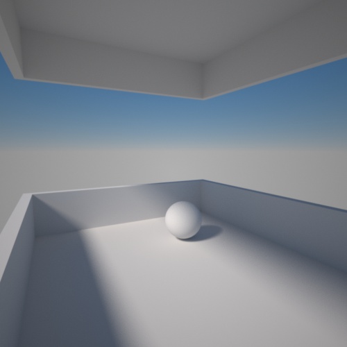

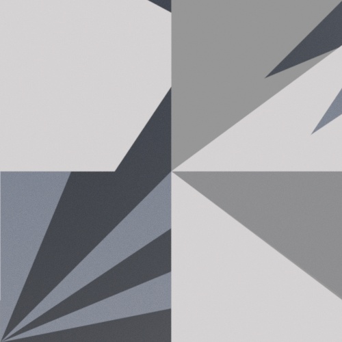

I set all my objects to baking group ID 3
I set my camera mode to baking.
I set my camera's baking group ID to 3.
I have attached the render from a typical camera for reference, and the output file from baking. But the output file from baking doesn't really make any sense.
The baked file that was created
A reference for what the scene looks like.

I went down to 2.х ... I'm not experimenting in 3.х - can not verify your problem
