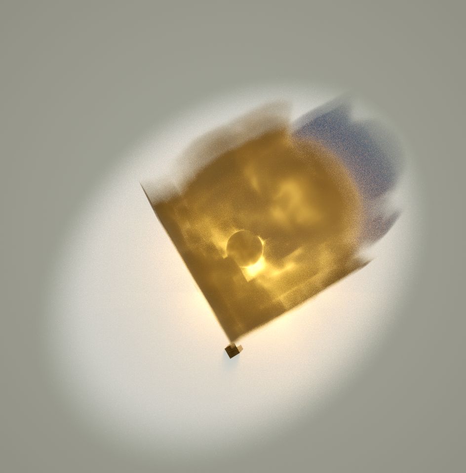

Here's a view from top. Black cube is the center of the Volume Object, but a corner of the VDB simulation. And two sides are cut, not so in Houdini.
Upload will follow.

I know what you mean. Propably i couldn't explained well. Houdini isolates a sub box which contains voxel by subtracting empty parts of volume. So resulted box is moving in domain.

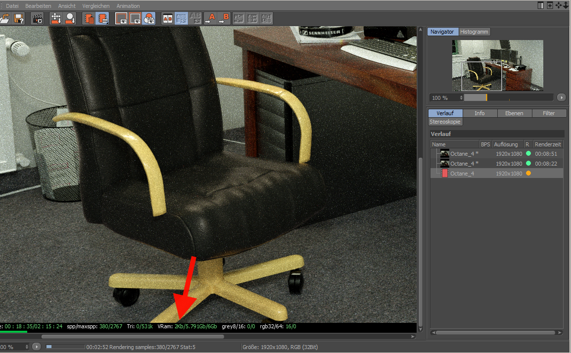

is the Vram Display buggy?
2KB?
Cant be true? :-)

NVN wrote:is the Vram Display buggy?
2KB?
Cant be true? :-)
I think you are out of VRAM. As you know 3.0 can use System RAM for render buffers. But there should be some VRAM usage for geometries. I'm not sure, maybe a bug.
