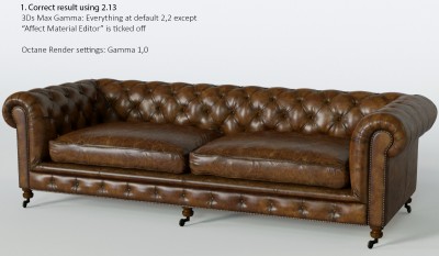

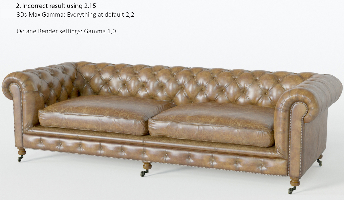

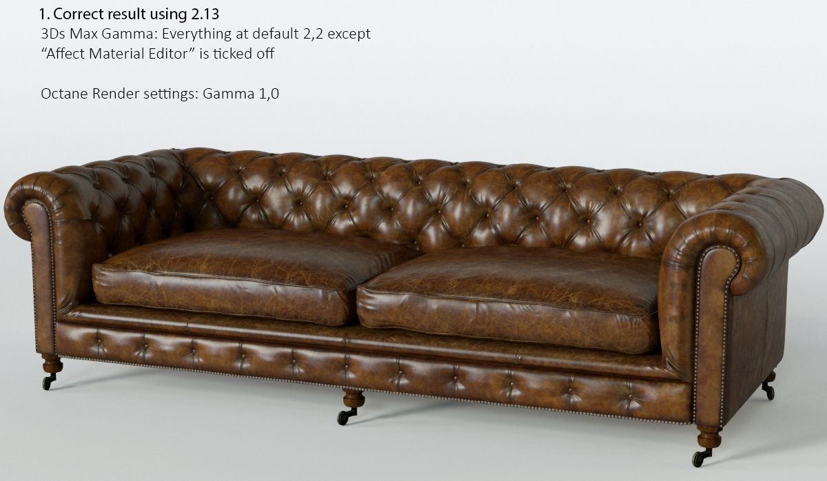

daniel.reutersward wrote:I upgraded to this version (2.15) from 2.13 and I´m a bit confused regarding the new gamma settings.
It seems like the response curves are not updated to correspond to the new gamma settings?
Before some response curves used either gamma 1,0 or 2,2, but now they doesn´t work properly?
I have a scene setup to use the default response curve (Agfacolor_Futura_100CD) and gamma 1,0 and with this version it looks like double gamma is applied (it looks the same if I would use version 2.13 with gamma 2,2).
How can I adjust the settings to correspond with the new gamma settings? If I use gamma 0,5 everything just looks wrong.
I like that I don´t have to untick "Affect Material Editor" in Gamma and LUT settings anymore to get a more correct material preview, but other than that I´m a bit confused.
Any insight in to this would be very helpful! :)
Update: I have attached 3 screenshots showing this. One screenshot also shows that the converter in 2.15 is acting weird/worse comparing to earlier versions.
/Daniel

I have attached 2 screenshots to try to explain my issue.
Picture "1.jpg" is the settings I´ve used for a long time. I have had "Affect Material Editor" ticked off in 3Ds Max gamma settings to have a better preview of the materials in the material editor.
Picture "2.jpg" is the result I get when I used this (2.15) version. I ticked on "Affect Material Editor" in this version since there was a change in material previews.
It feels like the response curves are still using the gamma settings from 2.13 and acting like there´s some sort of double gamma applied?
Hopefully I have explained better, let me know if you need more settings/info! :)
