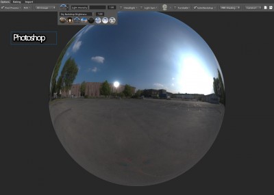

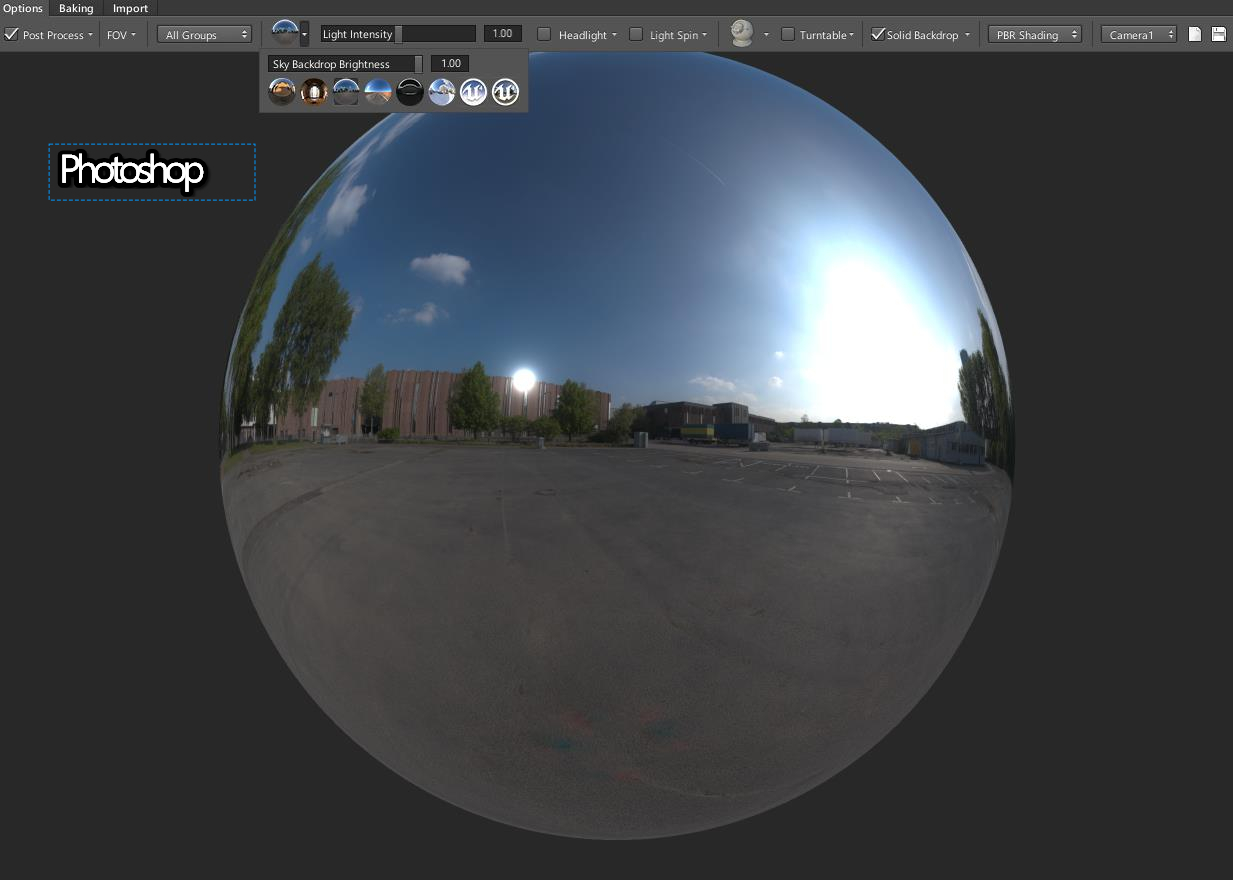

Here the material viewed in Photoshop loading a Quixel Chrome material

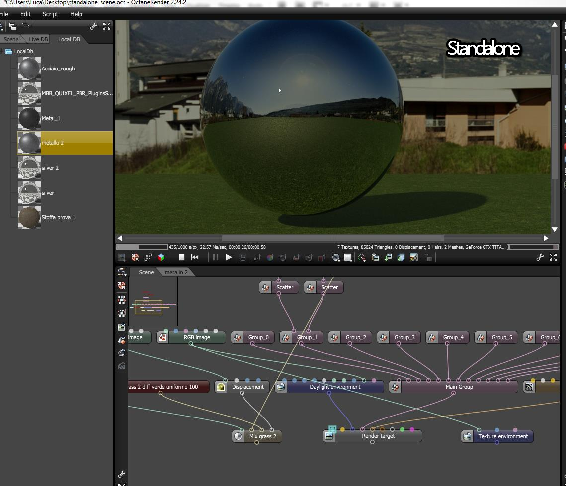

Here the material rebuilt in Standalon loading the 4 Quixel maps:

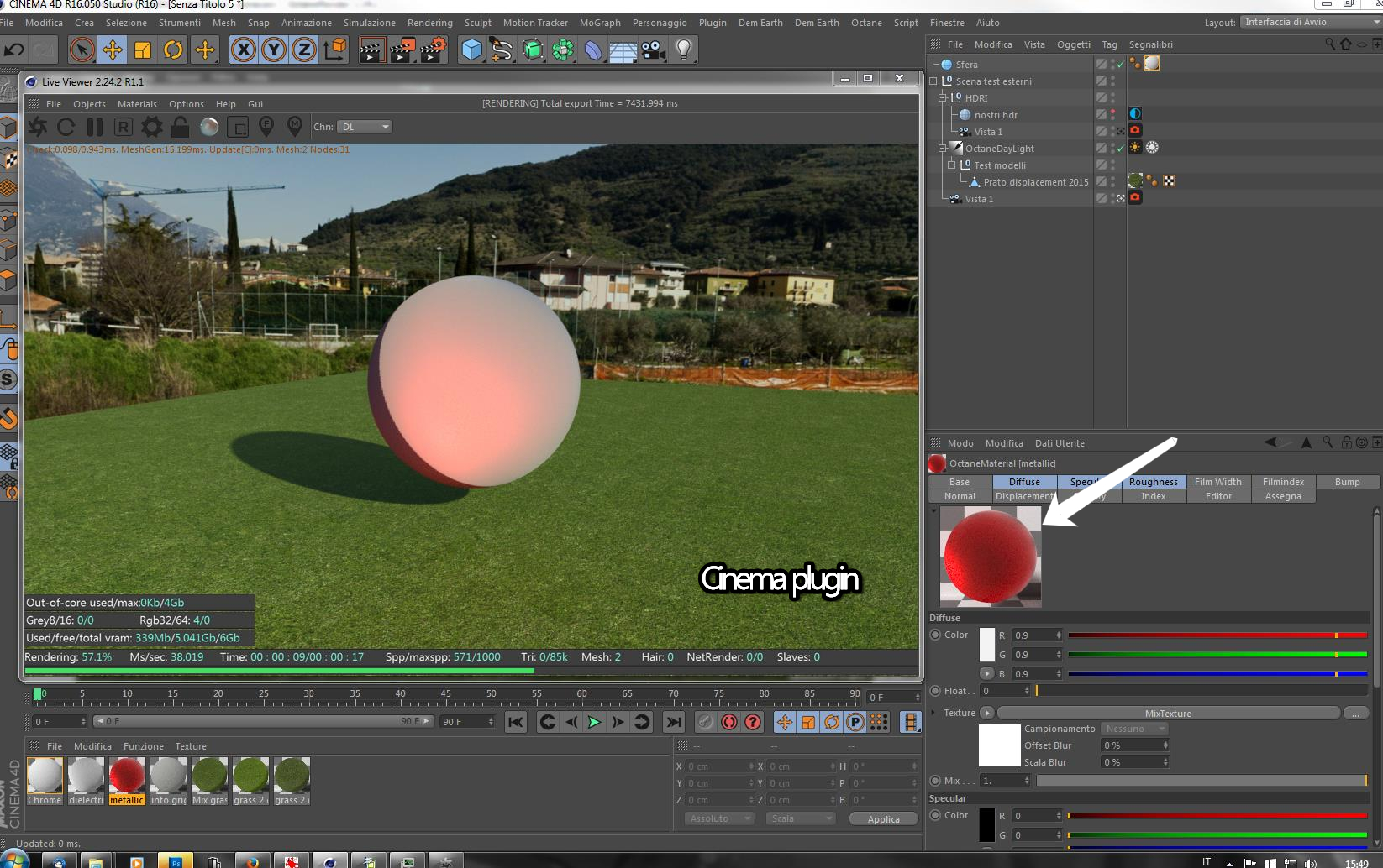

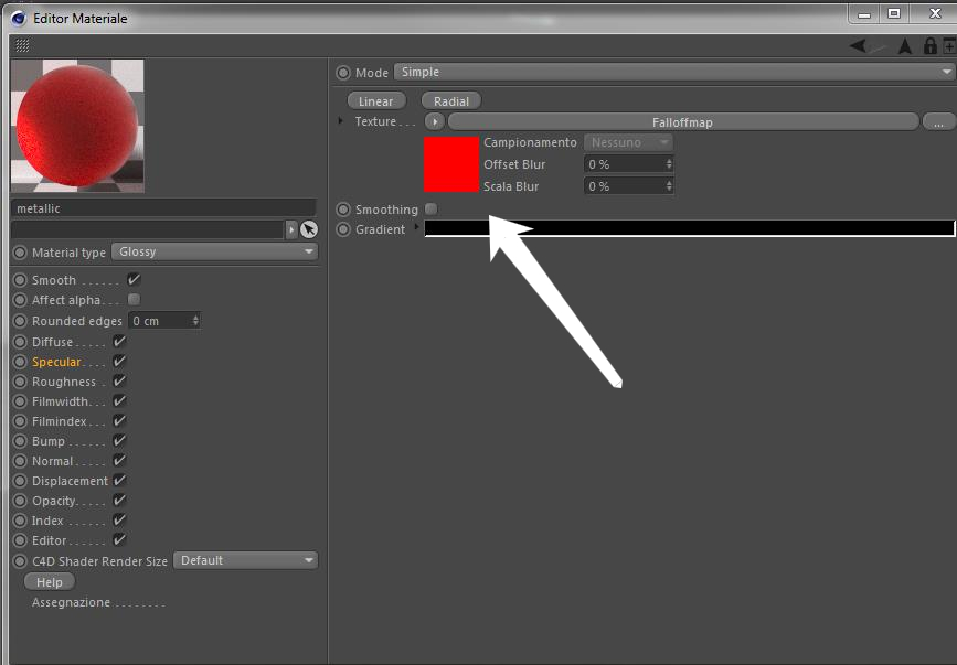

Here the material imported the .orbx in the same c4d plugin scene and the "red issue" on the specular channel of material

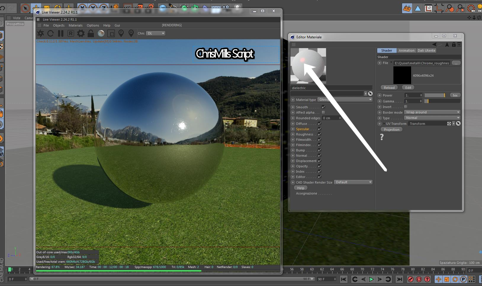

Finally the same material re-builded with ChrisMills script, that gives better results, but again with a problem with specular channel (more visible when you have less specular materials):
