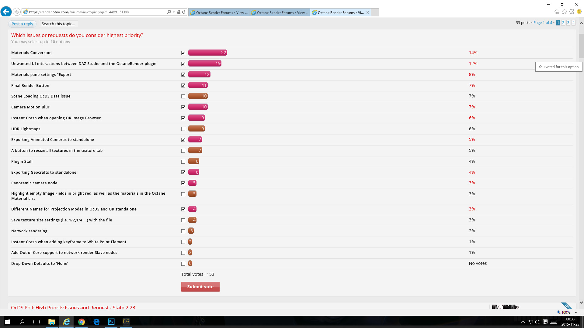

Update / Edit 2015 - 11 - 24:
- added status to the issues on the first page
green = issue considered solved by face_off
orange = issue partially solved or needs to be checked again in the next build
Face_off has allready fixed the first issues and is working his way trough the list.
Therefore the original purpose of the poll to give some feedback where to start has run its course.
The final results as of Midnight 2015 - 11 - 24 are:
Thank you all for participating and helping out providing feedback!
