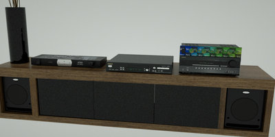

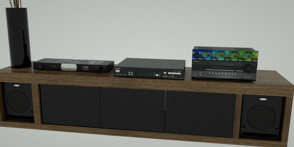

So, have solved the issue...
The problem was, that I has set a global variable to true if an object has an texture and to false, if no one was present.
If the last exported mesh has also no texture, the variable was false and no texture was written in the mtl-file.
I have remove that check and now it works...
The checked texture in the image I have used, because the imagefile was missing in your scene.

Great Job Face!
Now It´s perfect for us! Everything Is Fine.
Thanks a lot!!
