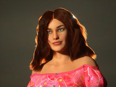

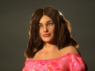

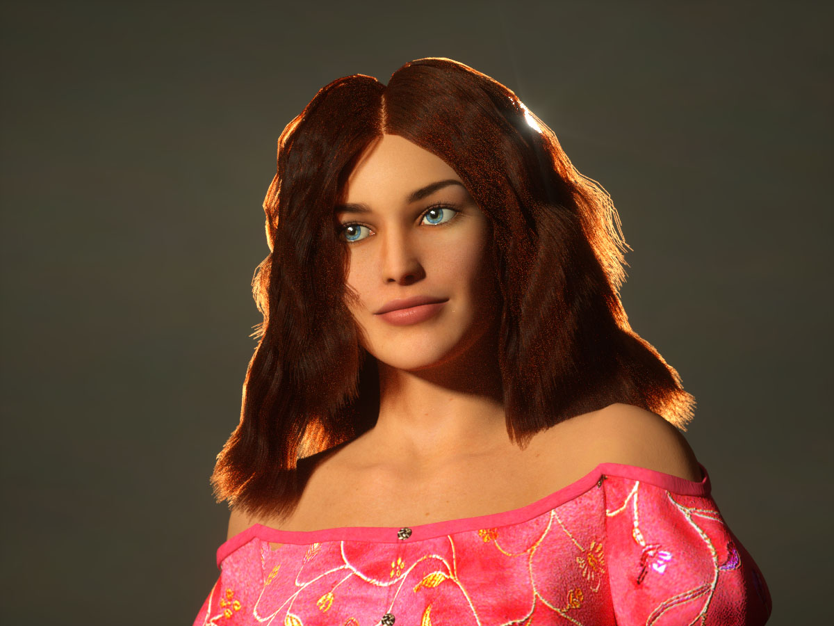

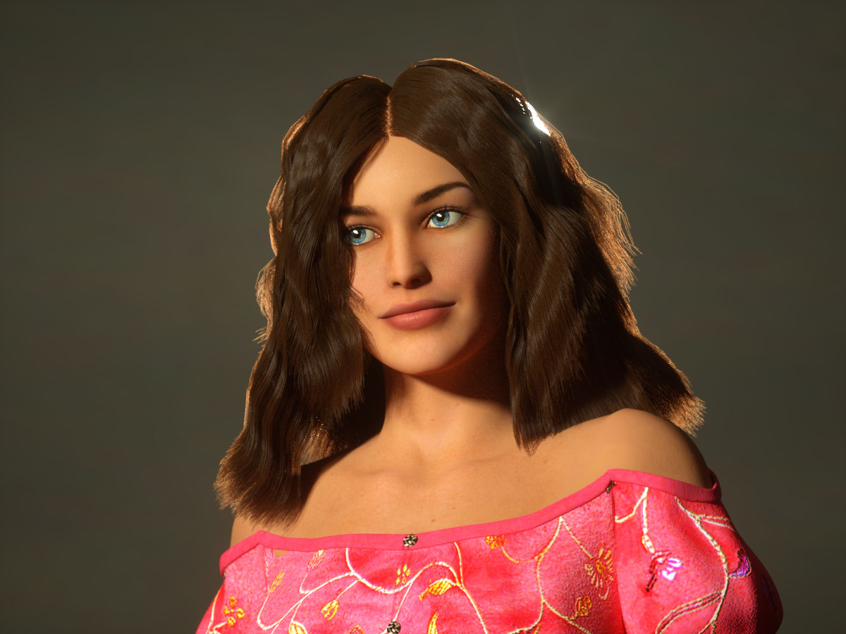

Latest shader tests, this uses some backlighting which the simple glossy material didn't react to as I wanted. I tried adding SSS without much success, then tried a specular material, which looked great, except it was very slow to render and quite noisy. In the end I tried a Mix material of the Glossy and Specular, which is getting there and was faster to render than the pure specular. Still work in progress!
P.S. The light at the back of the head is a sliver of the light I am using for the backlighting, not an intense highlight - just so you know!
Hair using a Mix material of Glossy and Specular

Hair with just a Specular material
