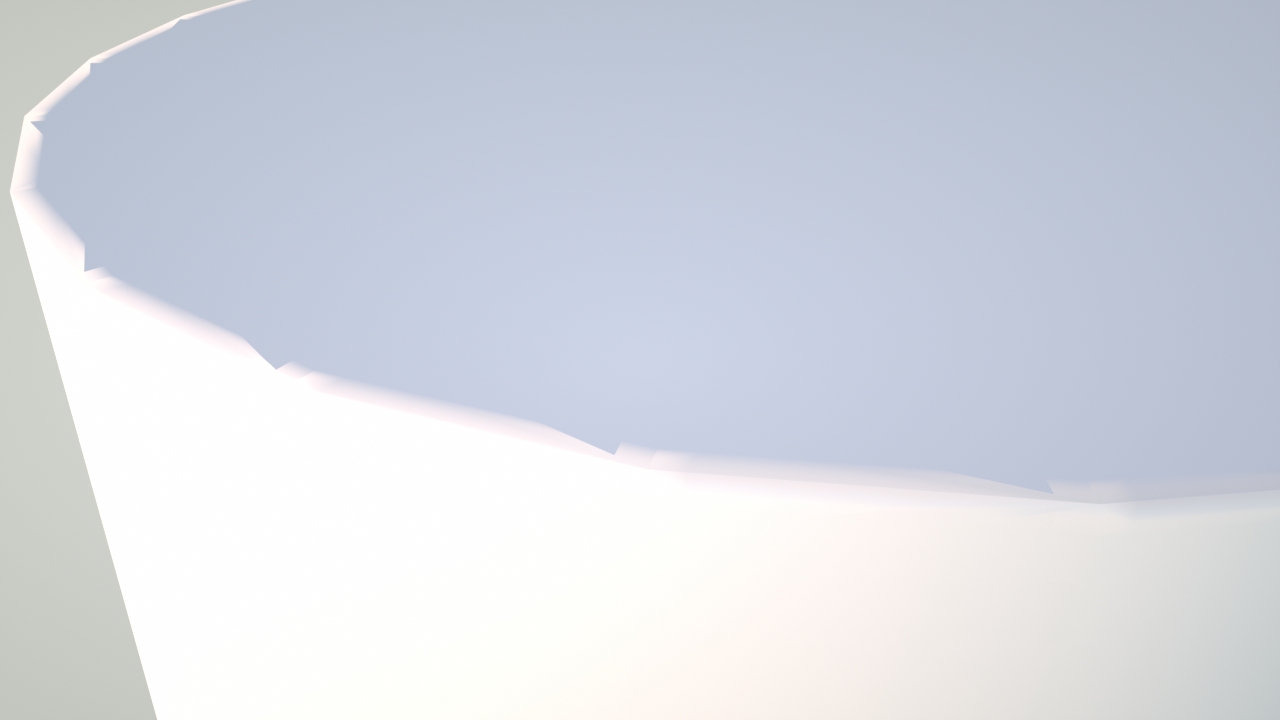

I am not so sure about those rounded edges which weren't usable from the start. Are they supposed to look this way ?

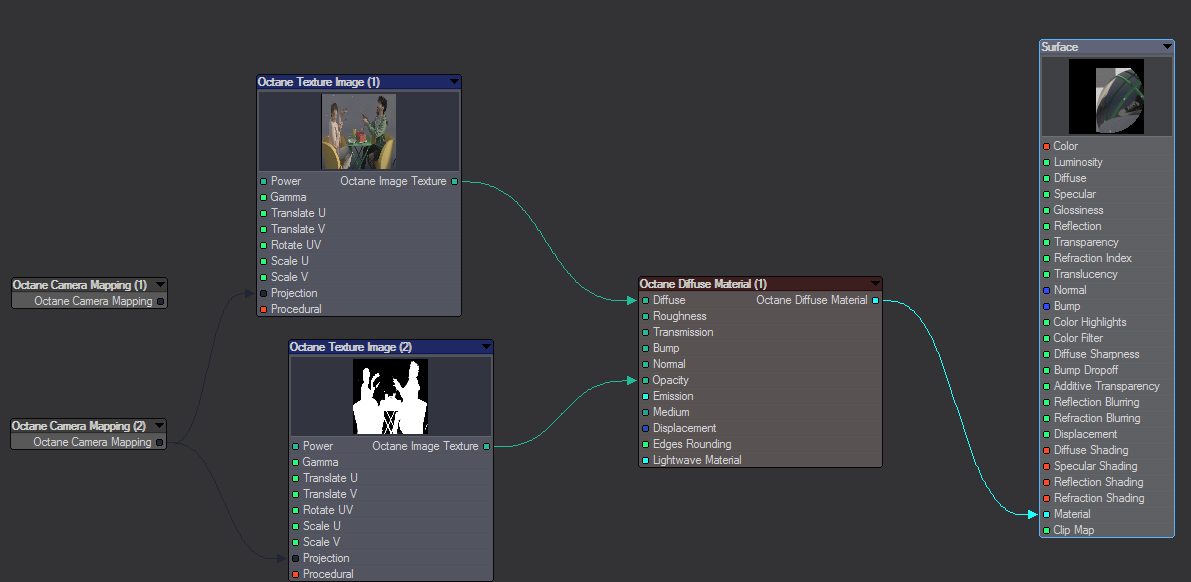

This node network does not work. You can't feed the same camera projection input to both image texture nodes. You need to have two separate camepra projection nodes and then it works.
