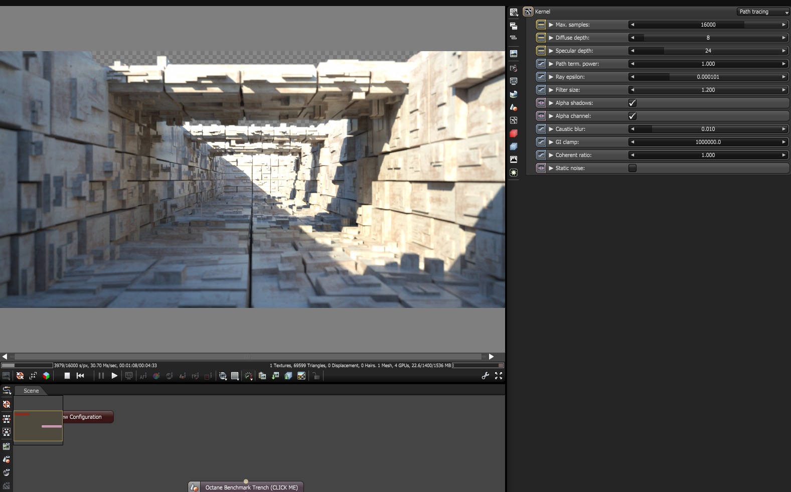

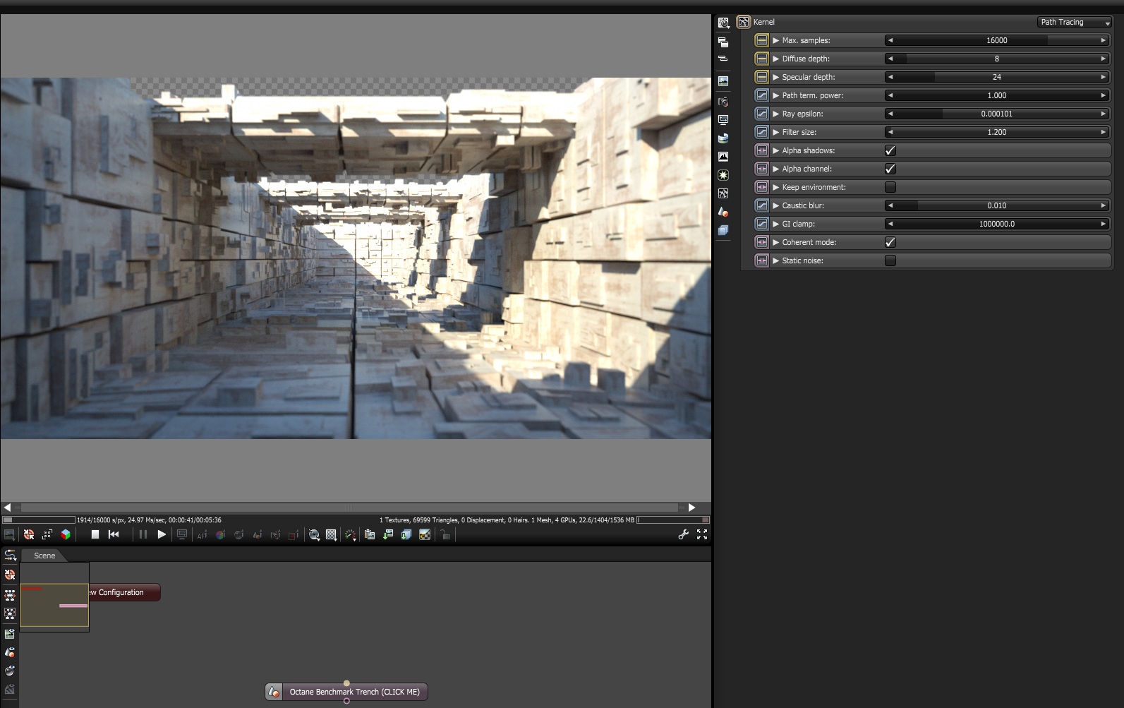

no way! :geek:
octane is even faster with 2.21?? I worked for months on 2.12 due to the new cuda toolkit 6.5 and lower performance on older cards due to maximum compatibilities with newer cards
but i`m checking now:
benchscore PT on 2.12 -> 24ms
benchscore PT on 2.21 -> 30ms
that`s some crazy coding

whersmy wrote:octane is even faster with 2.21??
You have set coherent ratio to 1.0 in 2.21, that's why.
Coherent checkbox switched on in earlier versions equals a value of 0.35 if I'm not mistaking...
That is right. Anyway 580/590 are still powerful, yet power hungry cards.
