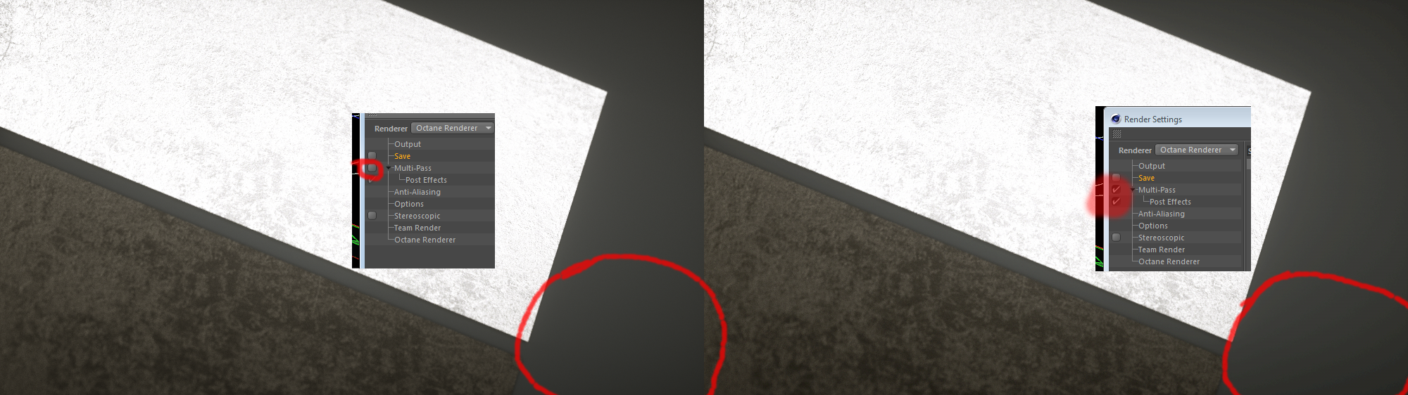

+ I don't know what it is and is it me or Octane...
banding
banding

Please don't use icons from both window. Just use on set and disable other. What are you asking for exactly?

"What are you asking for exactly?"
Just to check my PNG that explains that if to turn on MP than Main image have color issues (banding) as on png i showed.

use dithering for 8bit or use 16-32 bit images. Otherwise it's a display problem for your host program.

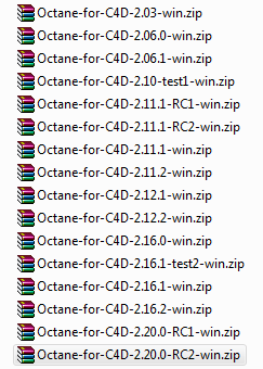

collection for history
