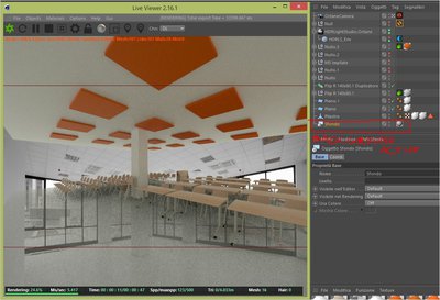

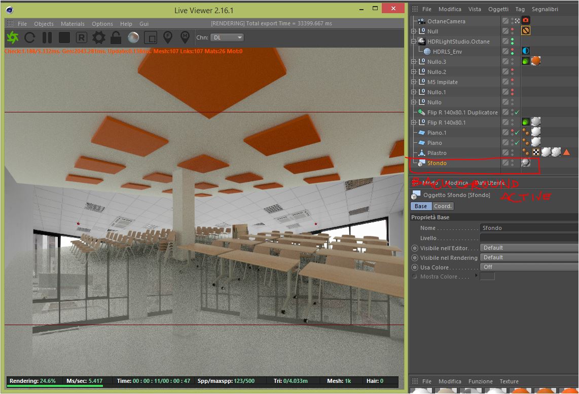

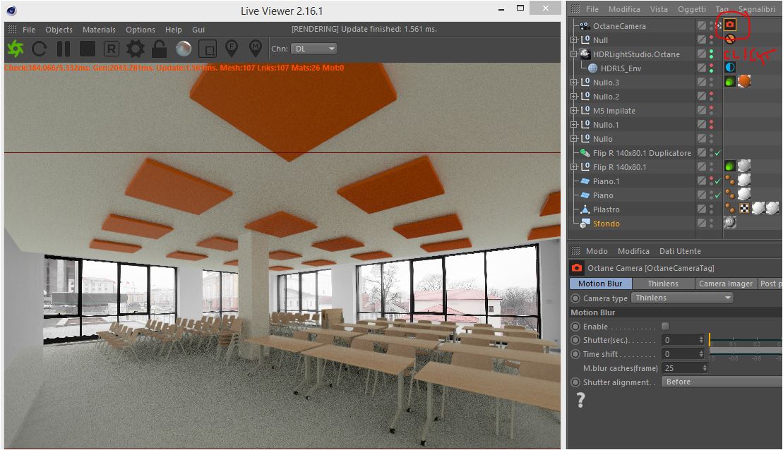

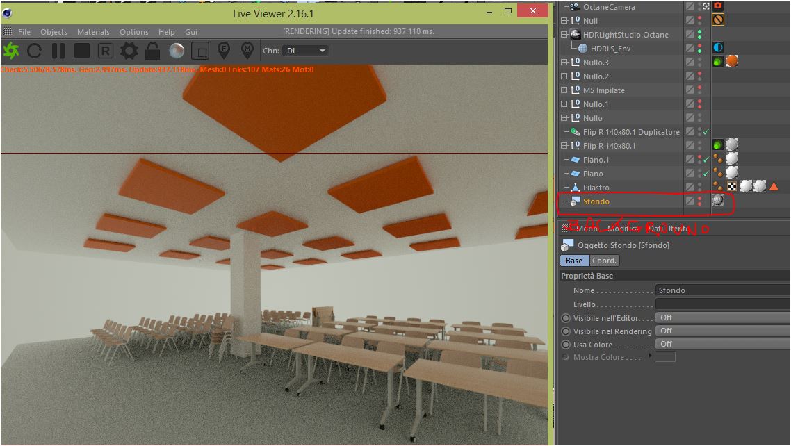

Hi Aoktar,
many thank for update the plugin, now the render works correctly!
I have discovered why the change of view by the camara occour, the problem is Background, if I disable it the view is correct.
As you can see the angle of camera is the same on each image but the background is incorrect. If you click on camera Tag the background go in right position.
The background was generated by Calibration camera.
click on Camera Tag - background go in the right position
incorrect view with Background enabled
correct view with Background disabled
