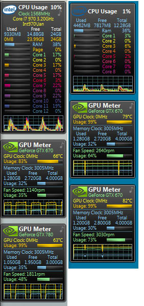

First of all;
Wow, this is a huge speed-increase !! I can get Noise free animations in less time !!
And Wow again, thanks aoktar for the fast plug-in update.
I'm still playing with the "Path term. power", but even leaving it standard makes a huge difference.
Is there a difference in the Update Method in the Plug-in?
I've done some tests with a scene with a litte animation in 2.06 and 2.10 ;
The Plug-in seems to export the scene every time, even when it's only the camera that moves.
In the screengrab look at the graphs;
on the left there's 2.10 where there is much more time between the GPU's rendering
on the right there's 2.06 where the GPU's almost render constantly
Win 7 64 24GB/ C4D R15 / 3xGTX780 3xGTX670

Hmm, checking. I may be corrupted some settings on videopost. Let me to check.
i copy that... 'send all scene data' or 'resend ony updated objects' have the same result in rendertime. and cpu-activity indicates send-all-behaviour.
Posts: 16067
Location: Türkiye
yes, there is a mistake which causes to ignore "incremental updates". I'll fix it in a few hours.
