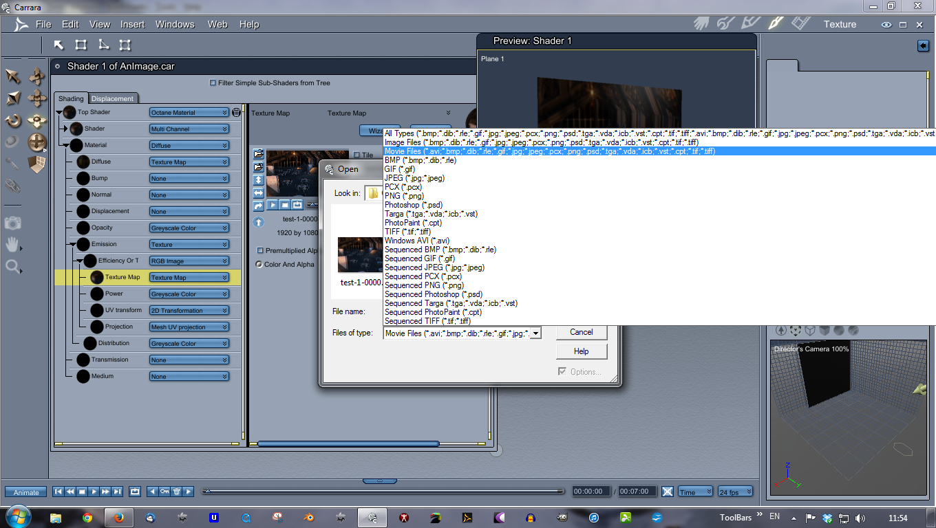

Having been very busy I have missed out on quite a lot but am catching up on things right now. Is there any further news you can give me regarding animated PNG sequences (or other sequence formats supported by Carrara as default) being an option please Sighman?
Being able to use them in your plugin would be great for many people all round. As things stand, you can use animated PNG and AVI (etc) files as a texture map within the shader room.. While the shader view of the animated seq does not update during scrub of the timeline (but is with the shader room preview), the changes do take effect in the final render using carraras renderer.
I can set up an Octane shader to work the same way but your plugin (AFAIK) has not been written in a way as to aknowledge changes in image frame numbers and update the LRVP/shader to show the next image in the sequence when scrubbing in the Carrara timeline.
Would you mind considering this at some point please?

I looked into this last night and I now know how to get a frame out of the sequence. The problem I currently have is that I don't know which frame to get. The frame rate of the video can be different than the frame rate of the animation and I need Carrara to tell me which movie frame should be shown for the current animation frame. I'm still investigating so don't give up hope yet.orion_uk wrote:Is there any further news you can give me regarding animated PNG sequences (or other sequence formats supported by Carrara as default) being an option please Sighman?

Sighman, I am grateful that you have even gotten round to looking at this what with all the other stuff you have going on! Thank you. I know its in safe hands so will sit back and await further news (hopefully reporting success) in the future. Once again, many thanks for taking a lookSighman wrote:I looked into this last night and I now know how to get a frame out of the sequence. The problem I currently have is that I don't know which frame to get. The frame rate of the video can be different than the frame rate of the animation and I need Carrara to tell me which movie frame should be shown for the current animation frame. I'm still investigating so don't give up hope yet.orion_uk wrote:Is there any further news you can give me regarding animated PNG sequences (or other sequence formats supported by Carrara as default) being an option please Sighman?
