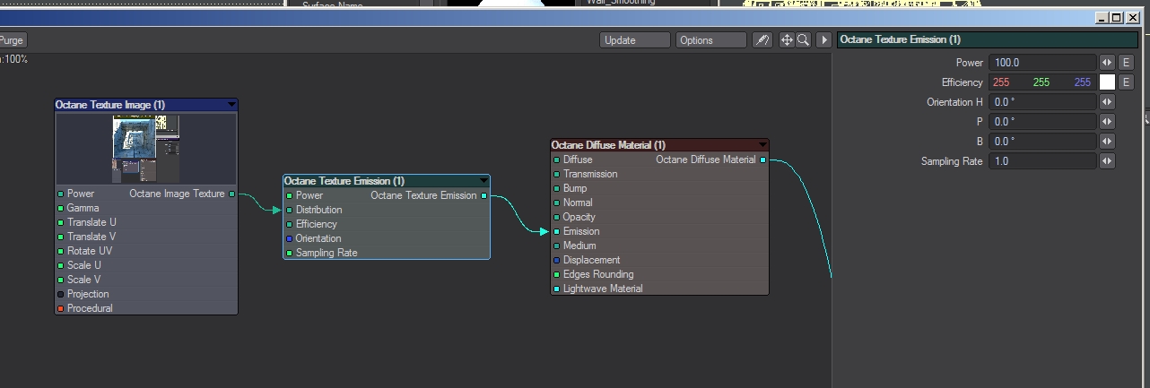

Hi should I do a luminous computer screen?
In Lightwave I would just add some luminosity to the texture...
Now I have a workaround by adding two Octane lights (one pointing to the screen and one pointing away from it) but it adds a lot to rendering time plus the luminosity is not constant all over the screen.
- Builtdown
juanjgon
Posts: 8867
Location: Spain
Why don't you use the texture emission node?
-Juanjo
