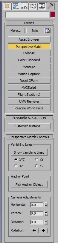

HHbomb wrote:I have a difference between viewport / octane viewport - octane render. With standard camera when using "Perspective Match"
Can't use octane camera because it don't work with target camera...
Do you use show safe frames option?
Do you use the same render resolution in common render settings and octane viewport resolution?

The problem is when I use "perspective match" (see capture)

HHbomb wrote:The problem is when I use "perspective match" (see capture)
HHbomb. As far as i know you can use the perspective match cameras with standard cameras. So after you have your match, why cant you just create an Octane camera. Hit P for perspective and then Ctl C to move your Octane camera to your Standard camera location and FOV.?

HHbomb wrote:@Karba
Strange : I can't render hair and fur in octane viewport ("geometry" in effect) in 3dsmaxdesign 2015.
"We" need a size link between octane viewport and render output
That is not what I asked
again...
