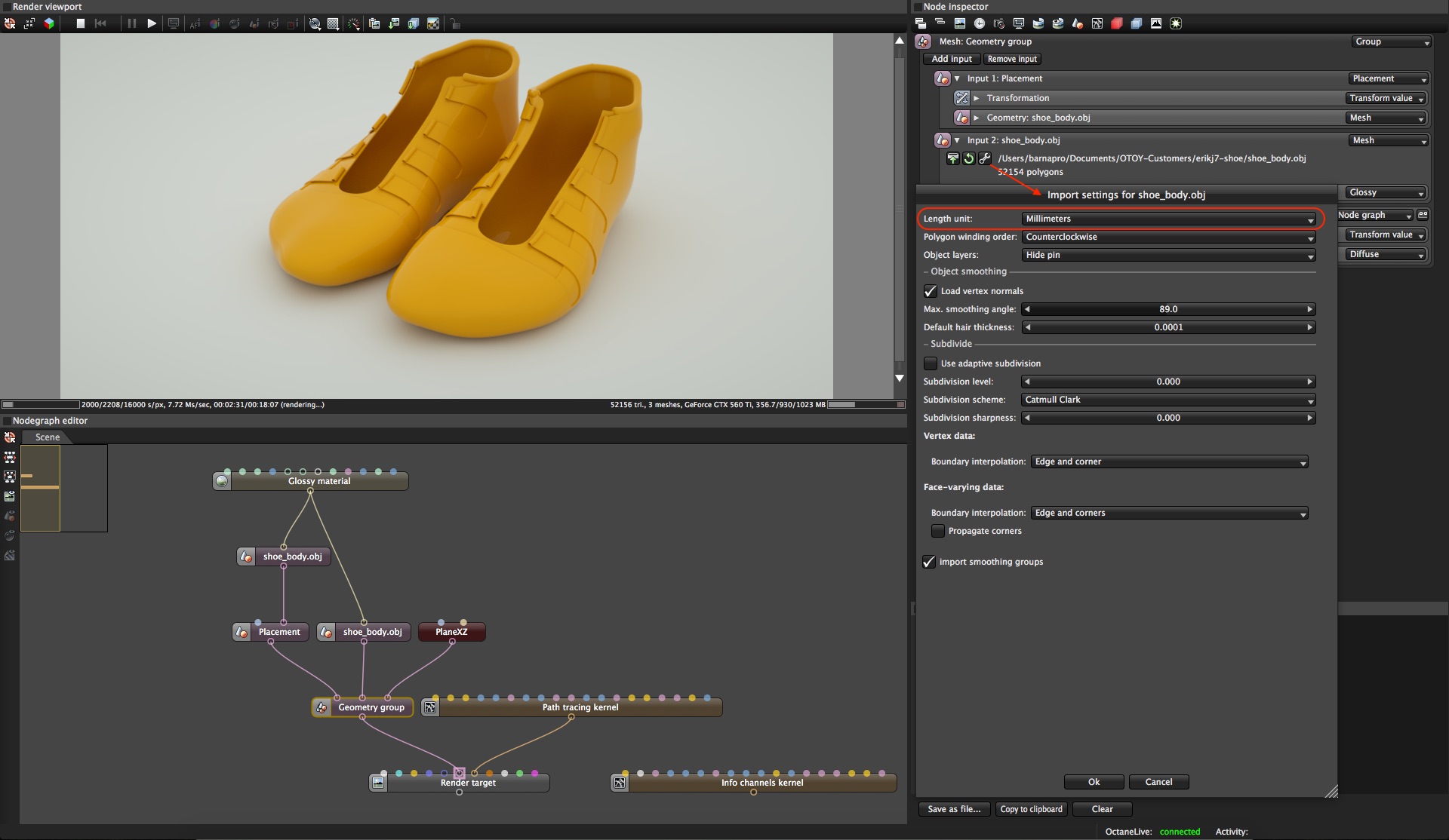

Hi Erik,
Octane works in meter, so , if your mesh has a different scale, you have to change the setting in the mesh preference pane. Here is what I get with the scale set to millimeter: and here is the scene with your obj: happy rendering
ciao beppe
ciao beppe
