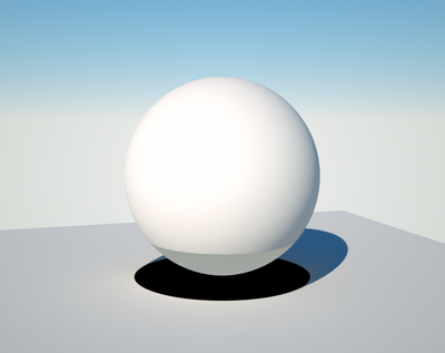

I'm seeing an odd issue. I just added a plane and a sphere (positioned just above the plane) to a blank scene. You'll notice both the black circle underneath the sphere and also the lighter gray surface of the sphere thats getting clipped or something. Not sure what's causing it, all other kits are disabled.
This look like a 'ray epsilon' issue. Adjusting that slider should rectify the problem.
Ah yes. I've never knowingly changed this, but somehow it got set to .1, don't know what the default is, but .001 seems to work.
