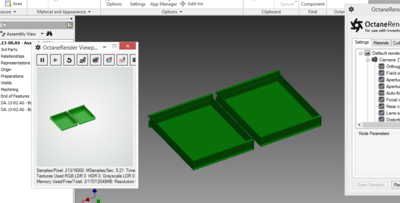

Cause it is hard to send thousand of files, I tried to delete unnecessary parts, until error is stay. And I find out that the quantty is not the main problem. Please, try to render files in attachment.Can you pls send me one of the big assemblies causing this error and I will take a closer look.

I downloaded and rendered the files in the attachment and got no error - sorry.Please, try to render files in attachment.

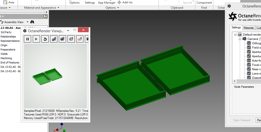

This is definitely materials problem. Part materials was reassigned to green in test assembly. When I have changed it to original part colour, problem is disappeared.I downloaded and rendered the files in the attachment and got no error

If you can give me some more info on the issue, or a sample file showing the problem, I can look into it in more detail. If you have a material "Steel" in assembly A which is blue, and a material "Steel" in assembly B which is green - the plugin can only handle one Steel material, so it will use the first one encountered. So if you have duplicated material names in parts, they should be the same Octane material - or rename them so they are unique. I hope that helps a little....This is definitely materials problem. Part materials was reassigned to green in test assembly. When I have changed it to original part colour, problem is disappeared.

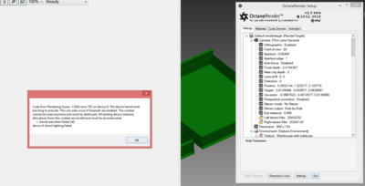

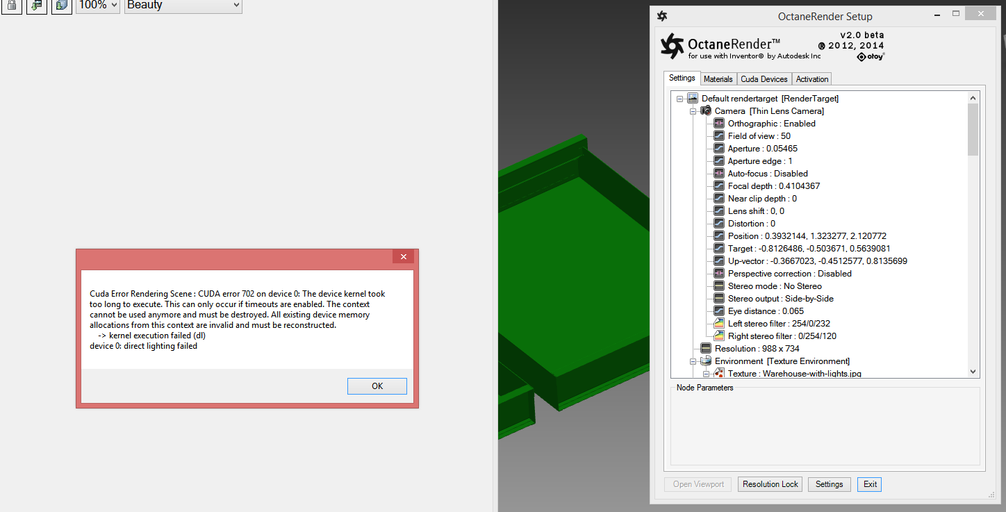

Hi Viacheslav - I don't get that Cuda error when I render that scene. Could you pls post a screenshot of the plugin Settings/Configuration dialog pls?Maybe this will help. File of assembly is the same - "test".

All settings is standard.Could you pls post a screenshot of the plugin Settings/Configuration dialog pls?

Can you post a screenshot of the Setting dialog pls?All settings is standard.
