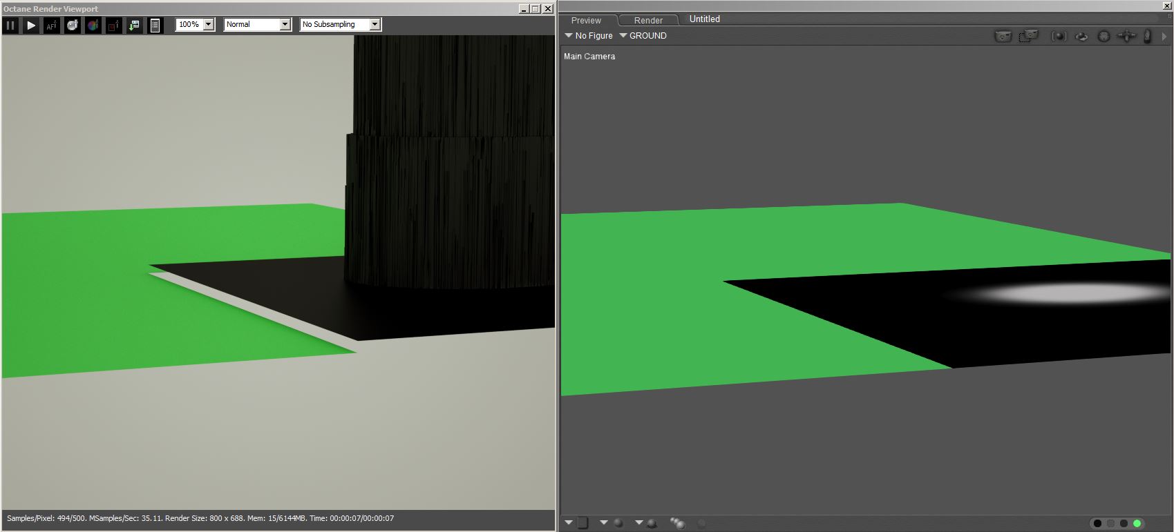

Another thing is that black on a displacement map shouldn't be able to move. But it does and on figures you can see a black line or a tear in the seams on material borders when using displacement maps.
I made a test scene with a plane that has 2 materials and one of them uses a displacement map. You can clearly see how the black part is breaking the mesh when using the displacement map. The black part shouldn't move at all.
I've noticed this as well. When not really careful, it's easy to 'break' the seam on textures (ie V4) when using displacement. The only counter I've come up with is to manage the displacement across all the material zones which is something I'd rather not have to do if I just want more localized displacement. Blood veins come to mind.
I have not been able to successfully add displacement maps to Poser figure meshes in the past (on Firefly), because the poser joint control morph bend the vertices that of on the edge of the body parts differently, so you end of with seams. You are seeing this in Octane too. The solution is to merge all the skin materials into one for that figure (and merge the diffuse, bump, etc texturemaps too into quadrants). I have done this for V4 and Antonia, and it works well - but is not easy!
Zay, this is a general Octane issue, so may I suggest packaging a sample in ORBX format and submitting to Otoy in the Octane Standalone 2.0.x thread.
