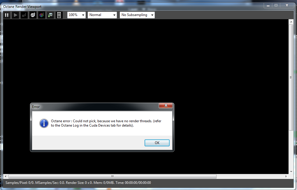

Render Animation. I just updated my nvidia drive to see if that would fix it. but now i got black screen
Updated to which version? Did you reboot after updating?

update 337.88 . i restarted and it renders fine but still no camera animation
