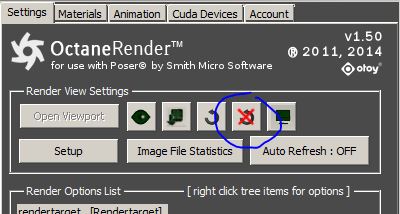

Did I miss something or doesn't the "scene lock" button stop your scene from updating until you hit it again?

Yep! That's the button!! Thanks!:D
