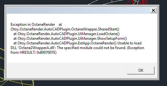

hi Paul,
Why Octane Render for Autocad 2015 2_0_9_1 beta 64bit can't use, is there any problem?
Pls Refer attached file
Thanks.
Can you try the latest build at http://render.otoy.com/forum/viewtopic.php?f=72&t=40517 pls.
Paul
kwaikeong1402
Posts: 26
Joined: Wed Nov 07, 2012 3:30 pm
OctaneRender for AutoCAD 2015 2.0.10.1 beta (64 bit) Ok Thanks Paul :D

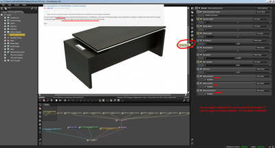

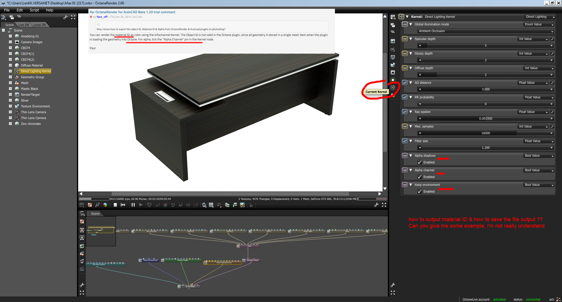

hi paul,
May I know how to export the object ID, Material ID & Alpha from OctaneRender & Autocad plugins to photoshop? :(
Thanks!!
face_off
Posts: 15760
Location: Adelaide, Australia
You can render the material ID as color using the Infochannel Kernel. The Object Id is not valid in the Octane plugin, since all geometry it stored in a single mesh item when the plugin is loading the geometry into Octane. For alpha, tick the "Alpha Channel" pin in the Kernel node.
Paul
kwaikeong1402
Posts: 26
hi Paul,
Can you give me some example, i'm not really understand.
Pls refer attached file.
Thanks you !!

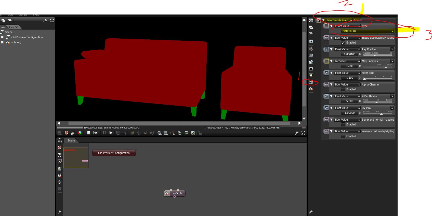

iViz3D
Posts: 145
Joined: Mon Apr 19, 2010 2:51 pm
Location: Singapore
kwaikeong1402 wrote:Kindly advise for the above question.Is anybody know about it?
Thank you!!
As what Paul said, you can explore these features;
1. at Kernel, choose infochannel
2. then Type, choose material ID etc.
3. Then render,
4. save image in PNG or EXR
5. open in photoshop.
sample MaterialID
sample MaterialID
